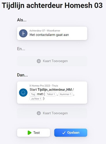

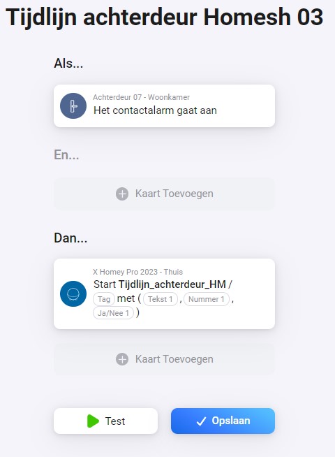

@Arie_J_Godschalk First i choose a IF card. Then i choose for the THEN card Homesh Controler, Homey Pro 2023, and then i choose a START card and then choose a trigger (puldown menu) for the Triggername, After that i can simply save the card in the Advanced Flows and it will work.

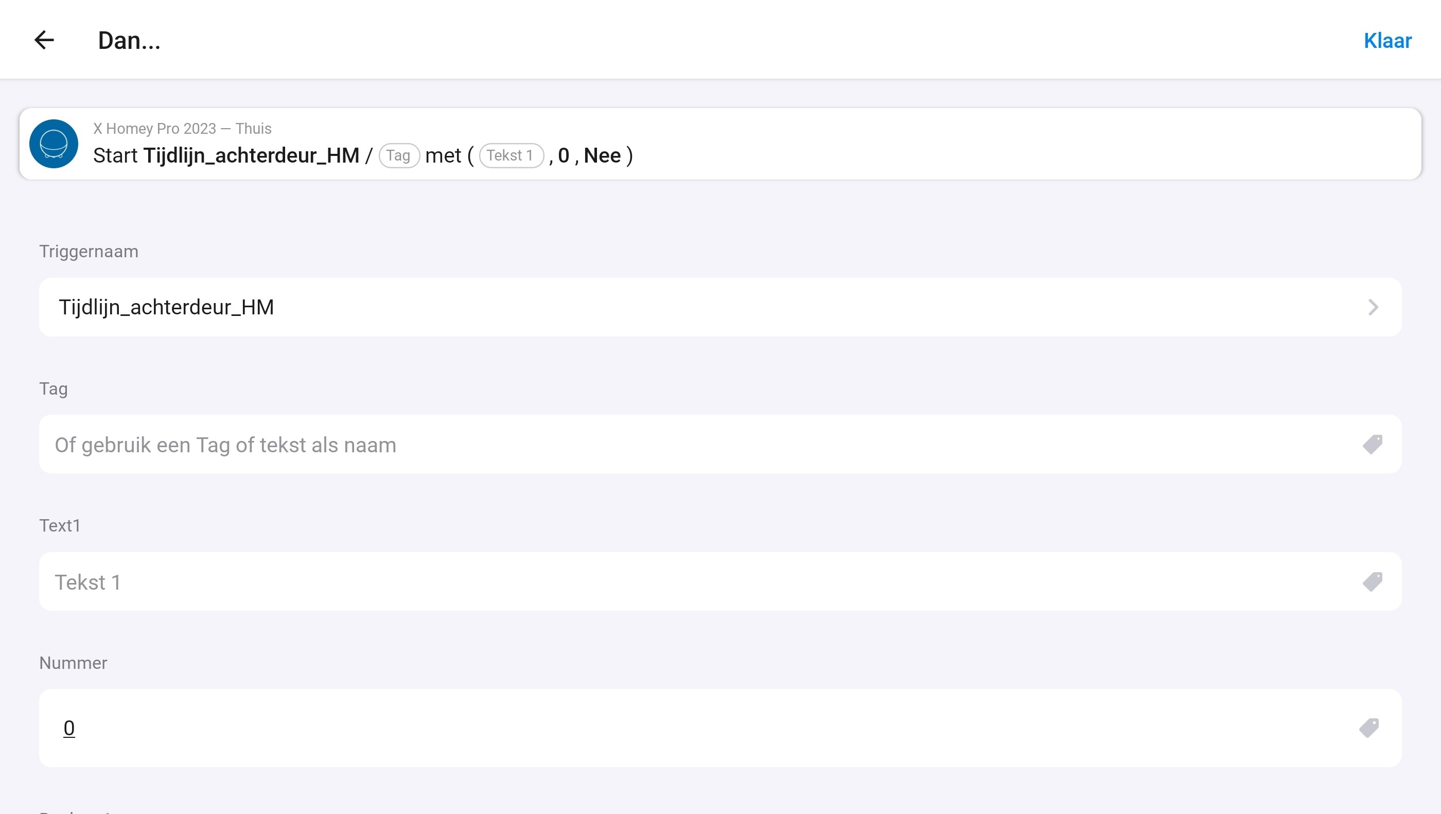

When i make a flow on my android Tablet or phone i choose first the same IF card, then i choose the THEN card, Homesh Controler, Homey Pro 2023, and then i choose a START card, i also choose the triggername again, (pulldown menu) but then I have to enter a number in the number field, otherwise I can not save the flow.
But this is only on the Android app.
On the pc there is no problem
Card on the pc This card can be saved.
Card on the Android tablet. Can not click on “Klaar”.
Card on the Android tablet, now i can click on “Klaar” after fill
in a 0 or another number.
Please report this to Athom, there is not much i can do about that.
