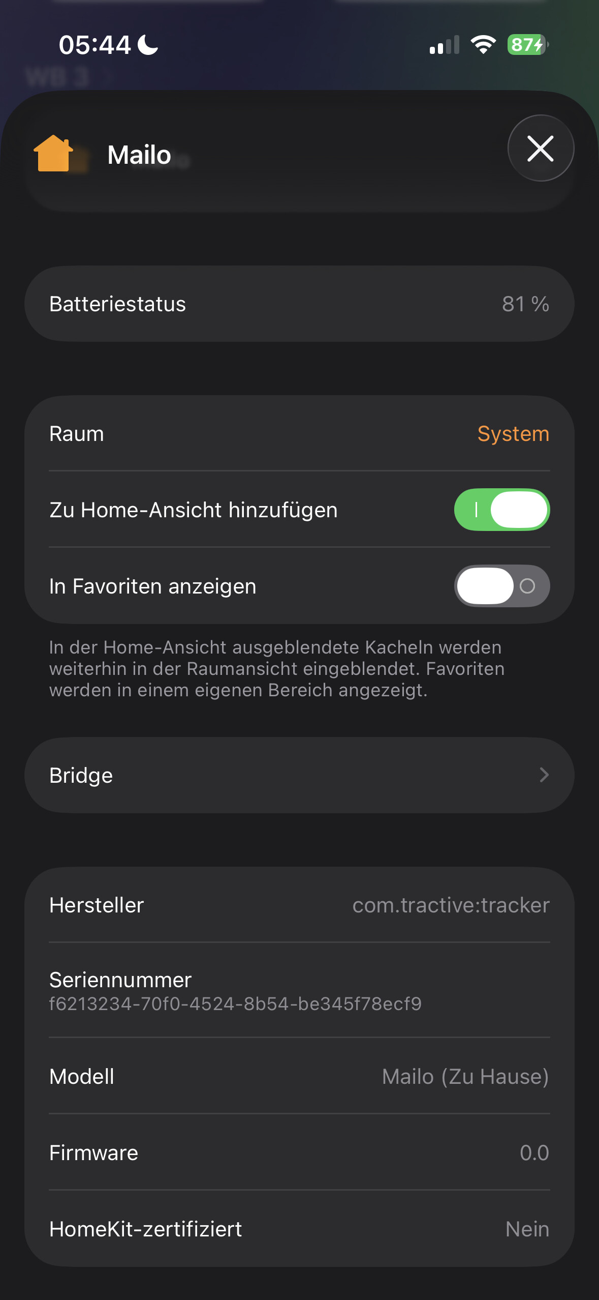

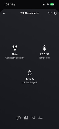

hi , i will report a big in the lastet beta version ,
after a short period , the devices don’t get status updates like battery % or onoff , and the adaptive lightning problem i can say that my devices now run perfect , before there was a problem by my tv devices for example .
When one of those capabilities changes values in Homey (you have to watch it for a while), create a Diagnostics Report and report its ID to me. Perhaps there’s more information in the log why it stops updating.
To generate a report, open the mobile Homey app, then go to More > Apps > HomeKitty then press the gear icon in the top right corner.
20deb6b1-3cb8-4492-948d-81ed2771ce3d , here the diagnostic report ,

I don’t see any interactions with the Rollo and Jetström devices in the log. First do the interactions, then create a new log.
I do see that the thermometer is being updated:
686 2025-10-30T08:09:38.815Z [log] [HomeKitty] [Wifi Thermometer] capability update - capability=measure_humidity raw=48
687 2025-10-30T08:09:38.824Z [log] [HomeKitty] [Wifi Thermometer] - update characteristic - name = CurrentRelativeHumidity value = 48
688 2025-10-30T08:18:39.153Z [log] [HomeKitty] [Wifi Thermometer] capability update - capability=measure_temperature raw=19.7
689 2025-10-30T08:18:39.164Z [log] [HomeKitty] [Wifi Thermometer] - update characteristic - name = CurrentTemperature value = 19.7
690 2025-10-30T08:28:54.795Z [log] [HomeKitty] [Wifi Thermometer] capability update - capability=measure_humidity raw=47.9
691 2025-10-30T08:28:54.973Z [log] [HomeKitty] [Wifi Thermometer] - update characteristic - name = CurrentRelativeHumidity value = 47.9
692 2025-10-30T08:38:39.787Z [log] [HomeKitty] [Wifi Thermometer] capability update - capability=measure_humidity raw=47.8
693 2025-10-30T08:38:39.810Z [log] [HomeKitty] [Wifi Thermometer] - update characteristic - name = CurrentRelativeHumidity value = 47.8
