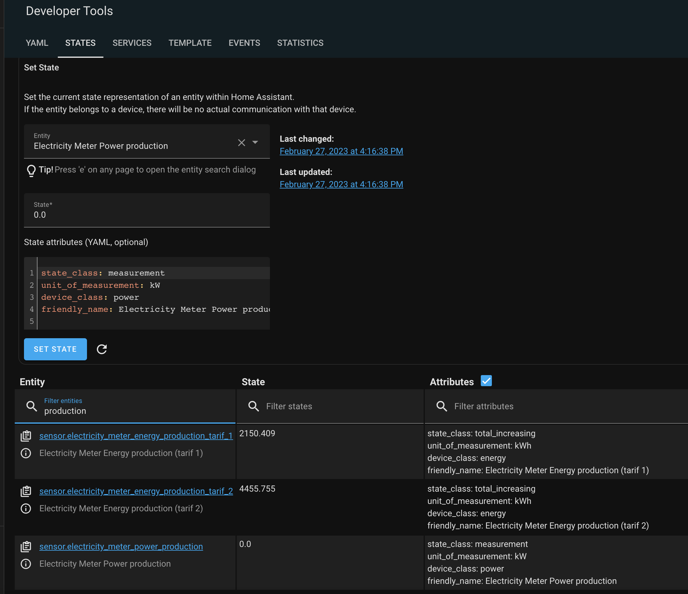

does this help.
The cumulative power entity is enough. The device itself is only a group of entities.
Can you please add these details? Thanks.

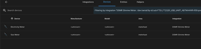

HA main page menu:
grafik
There you can filter the list (orange) or select one entity (yellow).
This way you get the technical names of entioty attributes.

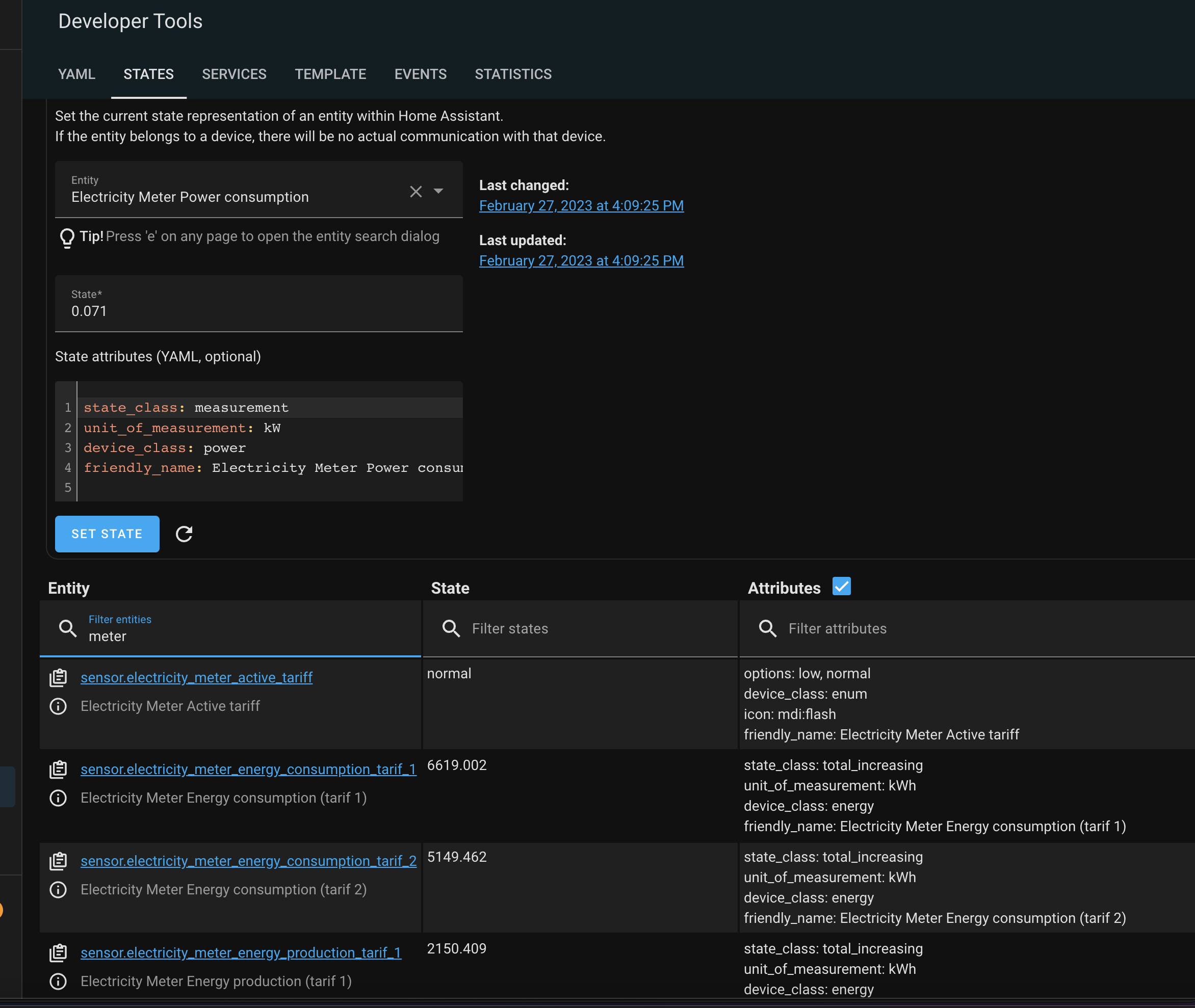

I have only an entity that comes from Homey (via MQTT). There I only have energy values but no attribute for cumulative energy. Perhaps you have different settings.
If not I wonder how HA will calculate the energy. Is it shown correctly as intelligent meter in HAs energy view?
So HA only uses the 4 meters 2 for consumption and 2 for production ( peak or week day-time and off-peak or night time/weekend/holiday) on their energy dashboard.
Also it provides in my case , production and consumption.
For homey. I think we need to combine the 2 and expose as meter_power (+ or - ) with the right class so energy dashboard shows it as a meter.

So as a temporary result I can say from the screenshots:
  • HA doesn’t offer an attribute like “cumulative”. It must be set/defines at Homey side.
  • Consumption/production is only defined by + or - value (?)
So a solution could be a compound device in Homey with a device settings to define it as “cumulative”. Then it hopefully should not make a difference is Homey is using both values for the cumulative sum.
true
but I guess the name of the capability is important and which class of the device is used. yep + is comsumption, - is production
No, the entity name is only a name. Important is the domain (sensor.), but you can’t read something from the name.

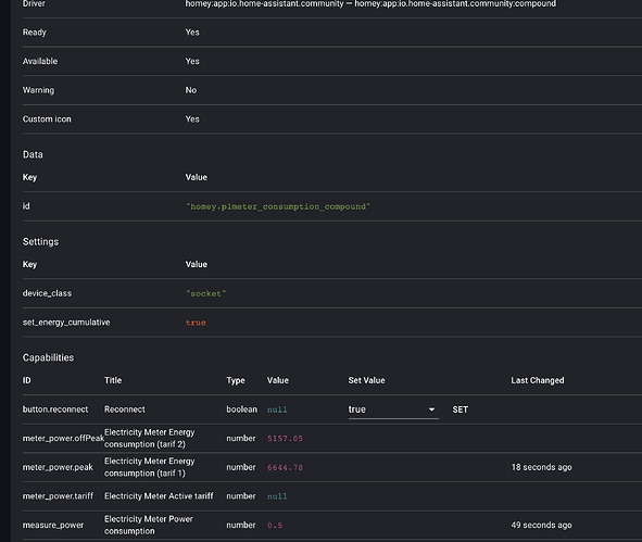

So I tried direct by selecting consumption and set cumulative power but this does not show up as smart meter. Same for production. But how to select my electric device, could only select 1 of the device entities.
then I tried to add 2 compound devices also these don’t show up as smartmeter
also can I add consumption and production as 1 value to measure power.

added some sensor somehow, now it works. need to find out what was the trigger. also saw a total parameter when I did repair.

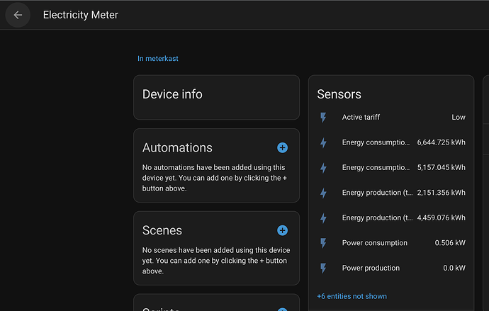

Homey device:
grafik
Settings:
grafik
Homey energy is showing the compound as smart meter:

Enable cumulative and do repair and update capabilities did the trick.
My devices have beed added already as sensor/compound and I only set the checkbox in device settings. The mobile app showed instantly the smart meters.
