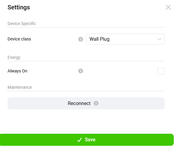

    You can select a device class for compound devices. This way you can define a compound as light or socket.
    grafik
    Using “socket” offers the possibity to set “always on” and energy settings for the device.
    There seems to be limitation: You need to have a onoff capability in your device. So just use “onoff” as capability name in compound definition for at least one entity you want to switch. Other entities can be added as subcapability “onoff.subname”.
    grafik
Some technical details:
It seems the additional settings (“always on”…) are added to the device at pairing.
So the compound is paired as socket, but tranferred to sensor later.
Wheater and which settings are displayed seems to be dependent on the GUI (WebApp, mobile app).
So changing device class to other classes seems to keep the always on setting which could be nice to use this also for a “light” device class.
Switching the device class to socket for a device that was not paired as socket seems not wo work because ot the static settings. So this socket dependent settings will only work for new added compound devices.

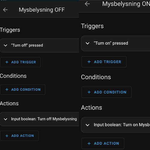

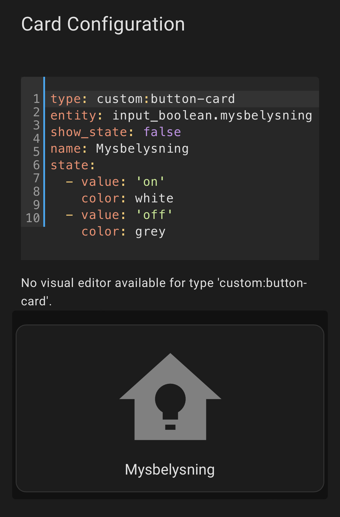

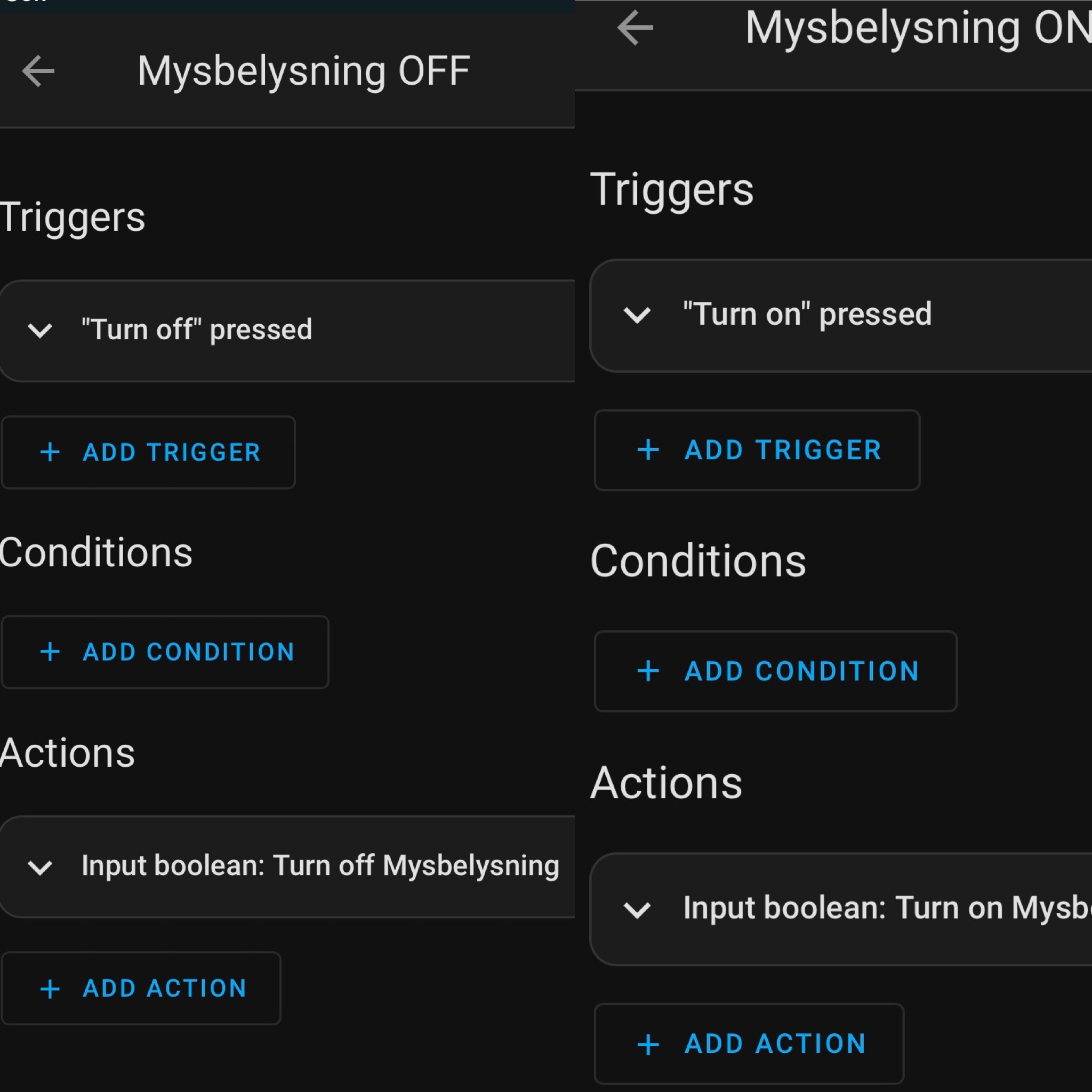

I’m playing around with ways to add buttons to Homey from HA. I’m really not that good at HA, but it’s fun experimenting. I saw a solution in earlier posts that is also very doable.
But, right now I’m trying it out this way;
  • Created a helper boolean named “input_boolean.mysbelysning”.
  • Created a simple automation in HA telling it to turn that Boolean on when “on” is pressed on the physical button.
  • and did the same automation but for “off”.
  • Created a custom button on a Dash that’s also controlling “input_boolean.mysbelysning”, changing the buttons color depending on on/off-state.
  • The “input_boolean.mysbelysning” can now be added to Homey either directly as a Switch or as Compound. (I chose Compound if I ever decide to use all the capabilites, like longpress etc in the future and want an easy was to add sub-capabilites)
  • The “input_boolean.mysbelysning” now reacts to the physical button being pressed, the “Switch” in Homey being pressed and the Dash Button perfectly mirrors the state.
  • The “Switch” added to Homey can now be used as a “When” in flows.
I’m not saying this is the best or easiest way. But my thinking is that when it’s time to build a dash I want to do it in Lovelace and I want States to be shown on the Dash no matter what triggered the automation, and then the foundation for that is already laid. And of course the button can be added as a sensor as well, but I chose this way right now :slight_smile:
Hopefully this may help some other HA-beginner as well.

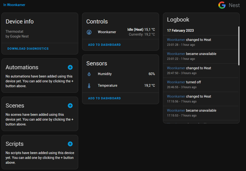

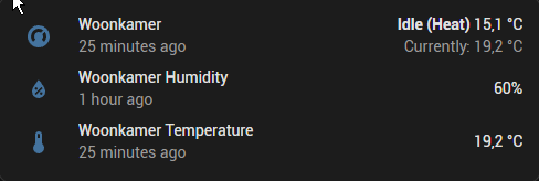

Currently I have a Google Nest Thermostate integrated as a device from HA. Several flows ensure that the pump of the floor heating is switched on when the thermostat updates HVAC = “heating” and modus = “active” until the modus is inactive (+extra time). However, these flows heavily depend on the availability of the thermostat.
In HA I can see the last updated data for the reported capabilities.
Using this data I want to create a flow that will notice if the link with the server down and the device is assumed to be unavailable. I’ve noticed that, if the device becomes unavailable, this is also reported in the HA logs.
Currently I can’t see any capability or variable that shows the device status. I’m not sure if this can be achieved by including a sensor such as measure_numeric (e.g. seconds after last update) or alarm_generic (HA reports the device as unavailable). However, I have no idea which data tu use for this sensor.
Anyone has an idea?

The entity state itself has value “unavailable” instead of on/off:
grafik
But I think there is no capability for in climate device, because there the modes are used.
Perhaps it would be better to set the Homey device as unavailable in this case. I’ll check this.

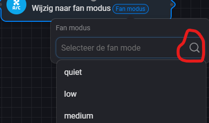

  • Climate flow conditions for ‘preset’, ‘fan’ and ‘swing’ modes are using autocomplete values now. The value list should present the current available modes of your device.
