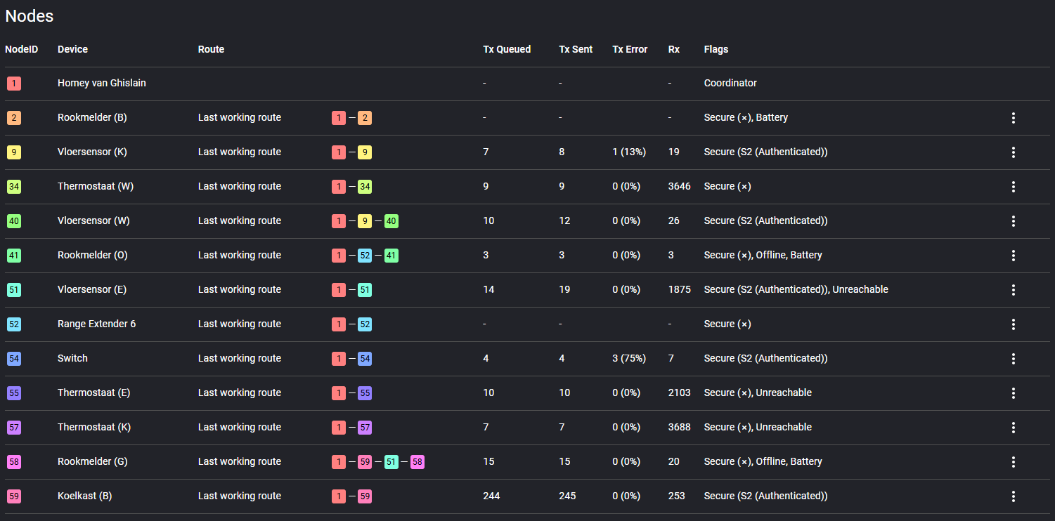

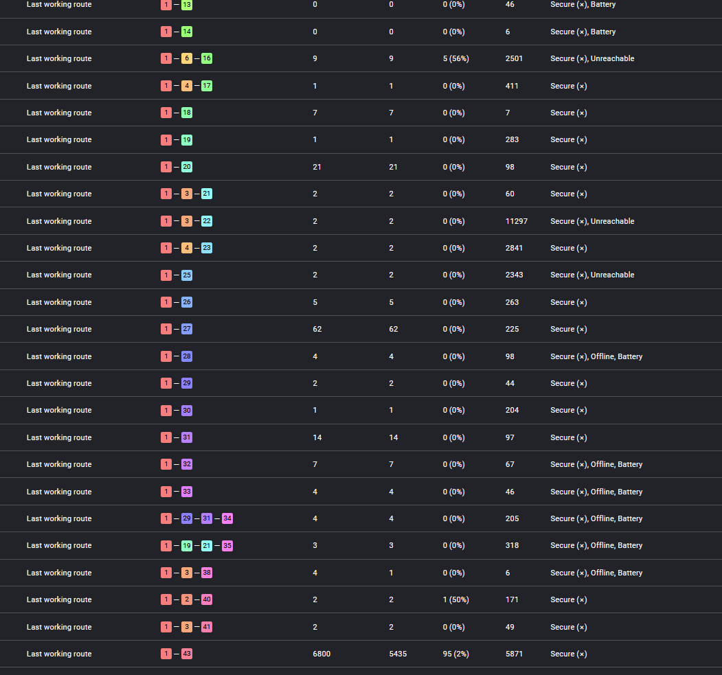

I also have big issue with my 10x Z-TRM6 and 6x Z-Dim2. causing the z-wave network to become jammed.
With lot of error messages in the Z-wave log on the developer page. LINK
Transmit failed with TRANSMIT_COMPLETE_FAIL_PHY
Homey version: 12.1.2
Heatit app: Version 3.8.8
I suspect that it is because of our new update that cause Z-TRM6 to act like this.
The update is to prepare for the upcoming Homey firmware update so that it won’t break flows
Simply exclude all of the Z-TRM6 and include it again.
The Z-Dim however I’m unsure what caused it. Do you have more detail to share?

I have excluded and included my Z-TRM6 again as advised, it still spams the network.
Please fix this asap.
Thanks.
Same here, worked before the last update
12 hours since rebooting, guess which device is the Z-TRM6…
This has to be fixed.
