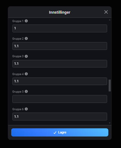

Hi, my Z-Relay stopped working after being flawless for months.
It updates when restarting the app, but I will not update by itself.
Did a work-around; everytime the relay activates THEN restart the app.
Problem started around oct 9, this is the assosiations:

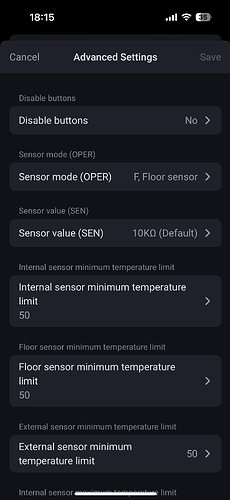

Hi. I have several z-temp2 thermostats associated to a z-water that controls my heating. Adjusting the set temperature on the thermostats works fine. The new set temperature immediately shows in the Homey app. However, if I change the set temperature in Homey, nothing happens. What could be the problem here?
Found a solution to this, by changing the min and max temperature limits in the advanced settings of the thermostat (z-wave parameter 11 and 12). They are default set to 5 and 40*C. By changing the input to 6 and 39, I was suddenly able to set temperature from Homey to the thermostat. Also found that the proximity sensor started to work after toggling it off and then back on in the settings. @HeatitControlsAB Seems like some bugs needs to be fixed
