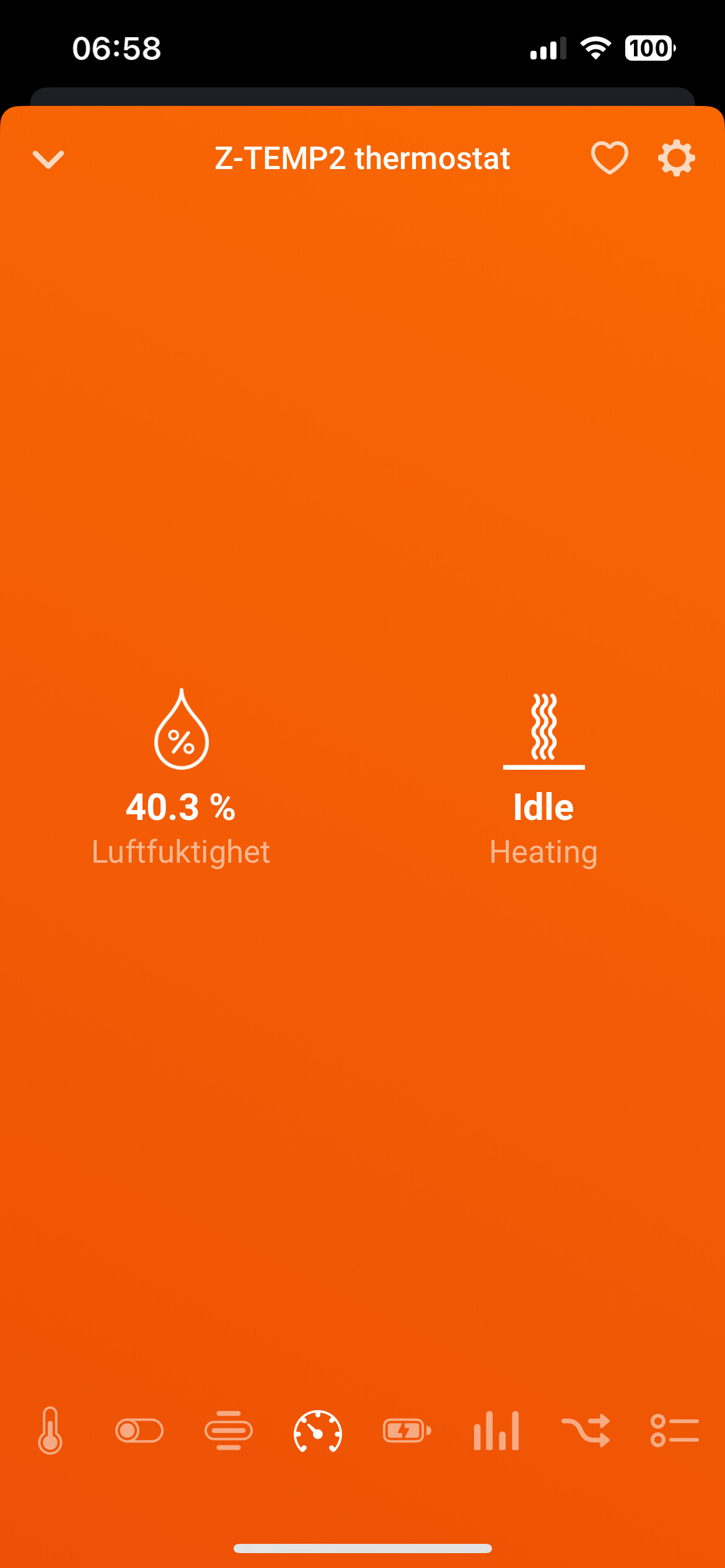

Hi!
I have two Temp 2, one have worked well for over a year but the new one doesn’t.
It clearly shows heating but at the same time indicates heating idle. And since heating is idle it doesn’t send a command to a flow.
Communication is ok if I check with developer tools. It also reports temperature back to homey, although somewhat slowly.
I have it configured as the old one.
Any insights? Thanks!

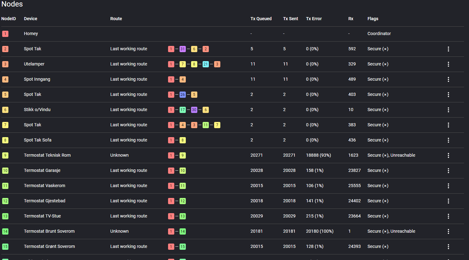

Have problems with Heatit Z-TRM6. They fall out of the Homey often. Have 9 of them. Currently 2 of them are not working anymore. Fix to make them work stable?
And dont look like they build a nettwork? “Brunt Soverom” is the one that is longest away from the Homey. But it stills connect directly. The Fibaro units in the same area of the house is connected through other devices.

I was hoping somebody could help me with an issue I’m having. Over a longer period of time my smart relays (fibaro single/double switches) which are connected to lights have been turning on randomly during the night without any flow triggered, since there are no flows connected to them. During logging of the z-wave network it happened again and it seems like my z-water regulator is triggering all these relays to come on at the same time. I’m no expert on the matter so I was hoping for some assistance in explaining to me what is happening based on the log? And if there is a fix to the z-water regulator to prevent this from happening?
Node 2 and 3 is my z-water regulators and the nodes marked in yellow are some of the relays in question.
All help appreciated!

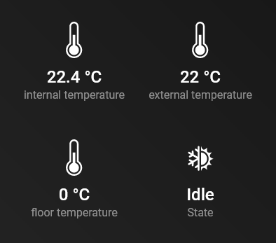

Status indicator for external temperature does not work.
I’m using the Z-TRM6 with an external sensor, mode A2.
Trying to change the status indicator to show the temperature at the external sensor.
bilde
However, the status still shows the current temperature at the internal sensor.
bilde
It should read 22 degrees, which is the correct temperature at the external sensor for the moment.
The external sensor is inside the bathroom and the Z-TRM6 internal sensor is outside the bathroom…
bilde
Could this issue be fixed?
Thanks!
