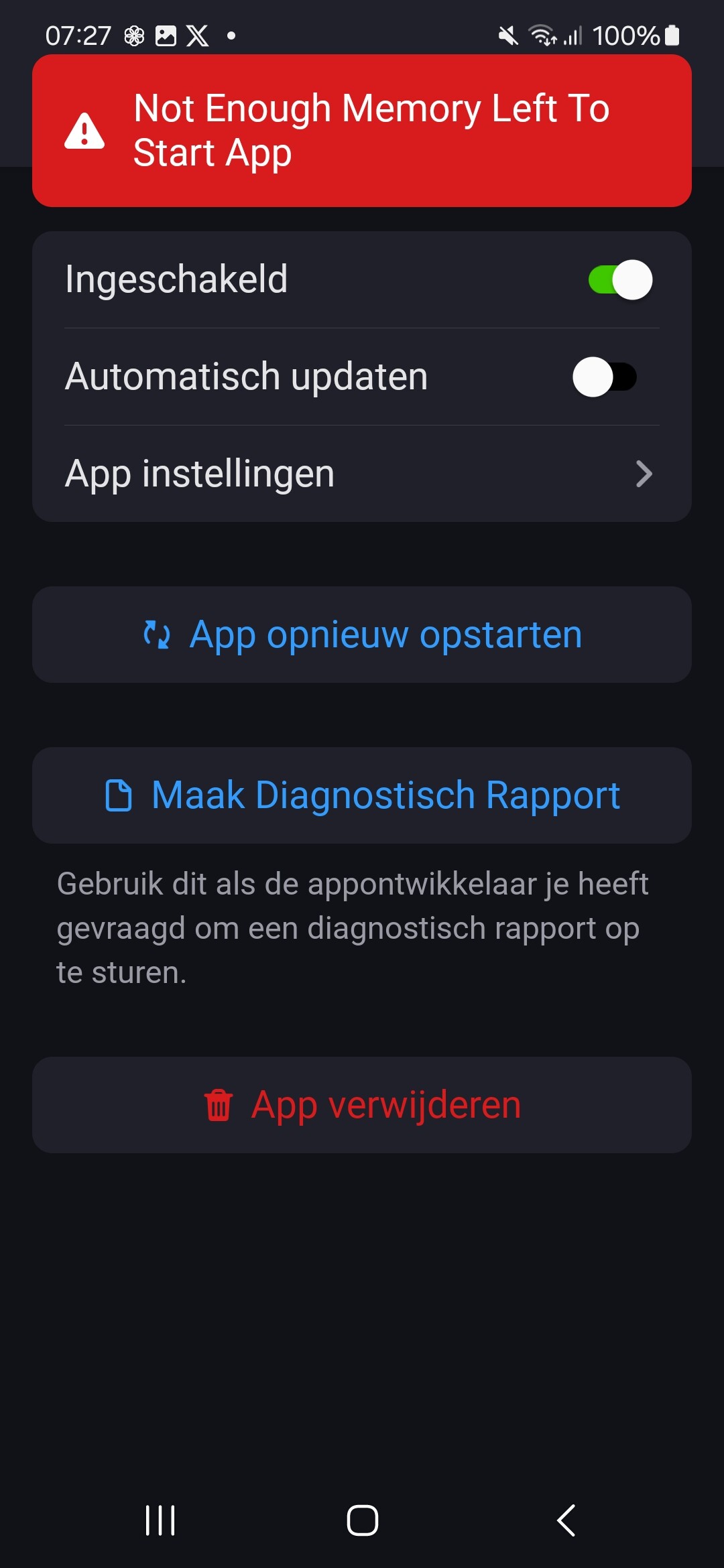

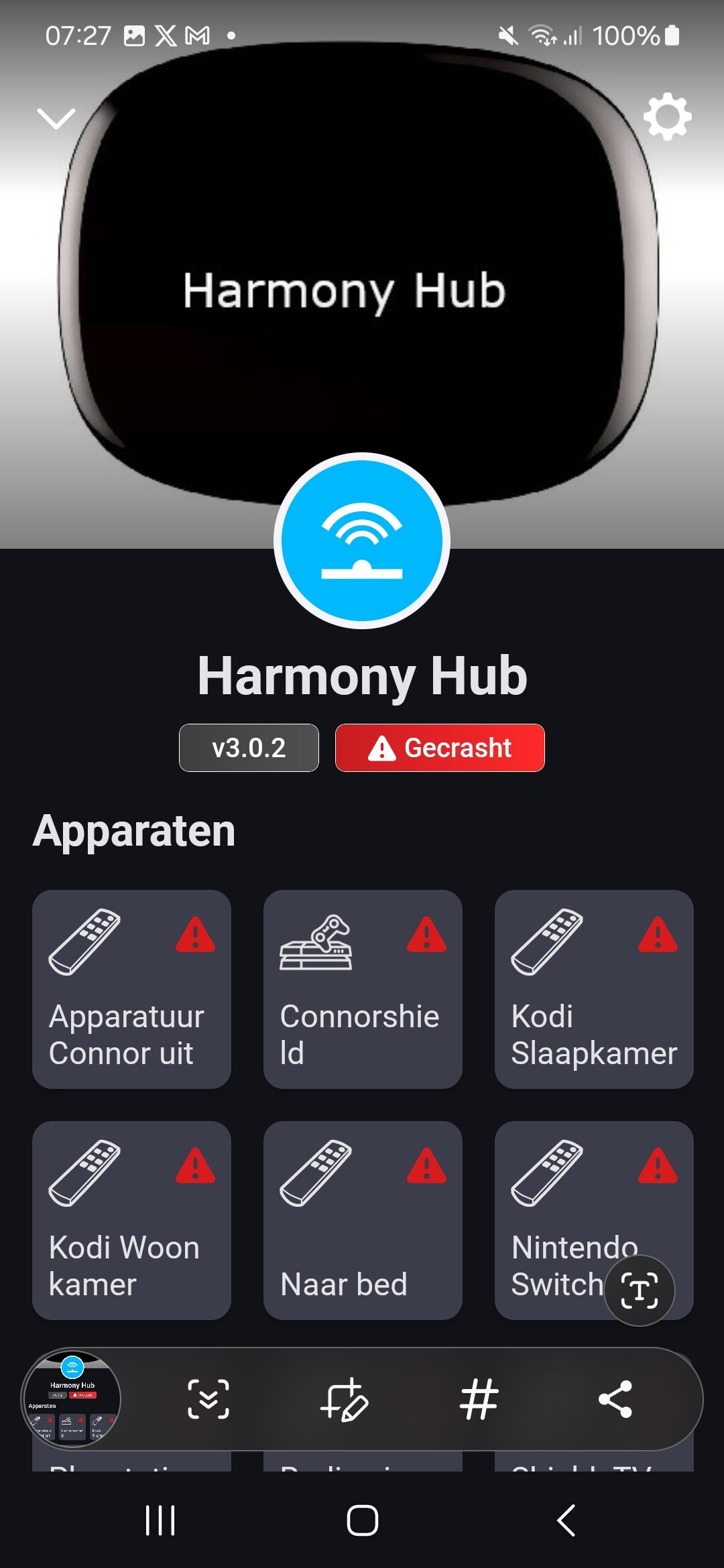

Since I got Homey 2023, I have often suffered from inaccessible Harmony devices.
It also happened sometimes with Homey 2019, but just as often as it has since May of this year.
Normally a restart of the app is sufficient to get it working again and I have now attached error cards to everything that automatically restart the app in the event of an error.
This morning I woke up to find that the app had restarted several times and still all devices had a red triangle with an exclamation mark.
I then tried again manually and saw that the app kept crashing.
Unable to restart the app due to lack of memory.
Strange because otherwise all apps worked just fine.
I restarted Homey and then everything was normal again.
