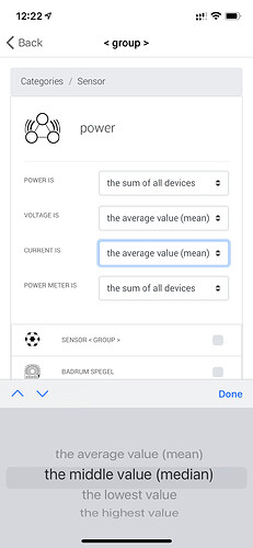

1+2 = showing half of actual value.
2+3 = showing half of actual value.
1+3 = showing half of actual value.
1+2+3 = 1/3 of actual.
I haven’t got a similar group to check, but if you go to the app configuration, for sensor values you can usually select the method of value calculation. Seems like it’s average now, should be sum. Maybe the setting is there?

But I can’t choose “sum”?
Also, “show all values separately” would have been nice as an option :blush:
If you ask nicely :wink: and donate some :coffee:
Maybe Jamie sees a possibility to add “sum of all devices” option for the “Current” sensor at a next release.
And why do you like to see the individual values of the grouped sensors also?
You can view those in their tiles alr.

Separate for the voltage makes sense since it’s more of a constant/error warning and their averages doesn’t really say much. One might show a bad value but have the sum be OK.
I use this card to get an overview of all meters together. Voltage is not that important though, you can remove it altogether without loosing relevant info. But since it’s there, it would be nice.

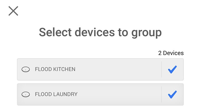

I can group my two flood sensors.
Select Alarm:
Then Water Alarm:
I can now group my water alarm sensors:
