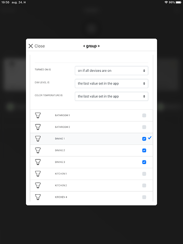

Hi Trobjorn, I’ve managed to get my ikea bulbs work under “groups”.
First go to devices, add new, select group, select lights, add ikea lights. Then go More/ apps/ group/ configure. Here you have to configure your bulbs, like this. Then it works.
And yes, I’m on homey 5 too.
