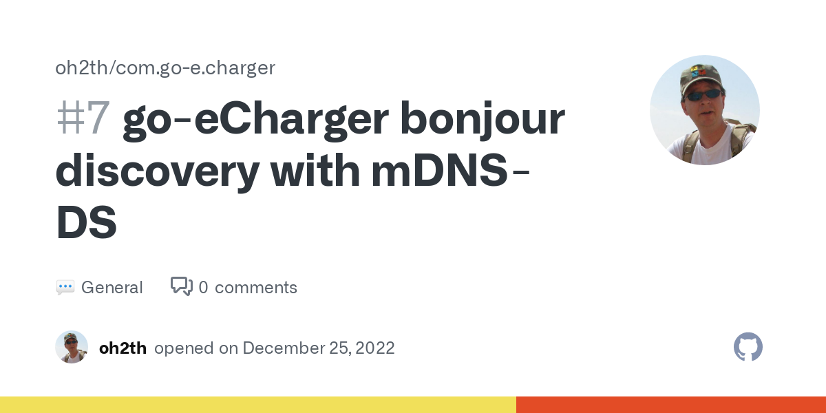

Question to @Picsou621 , does your V3 advertise itself for mDNS discovery / bonjour?
Same goes for mine, though different Mac
bc:dd:c2:
OK, then MAC address discovery might become quite complex as a number of different vendor parts would need to be listed for the discovery.
Manual IP might be god to have regardless.

Anyone with CM-03 (3rd generation) device who could help me check if the device is automatically discoverable on your local lan.
Here is a quick ref how to do it on Windows or mac OS:
Thanks @Picsou621 for the discovery result from a 3rd generation device. It now looks like the renewed app will support all current generations:
  • 1st and 2nd gen with manual IP configuration and V1 API
  • 3rd and 4th gen with automatic discovery configuration and V2 API (no need for V1 API to be enabled).
