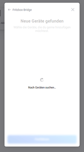

I have seen an example of Rollotron DECT control via the FritzBox and wanted to use this possibility. Now i can see the blinds control added to the FritzBox Smart Home page and i am able to move up / down and to defined percentage levels. But i cannot add this device to Homey Pro using the FritzBox Bridge. The first dialogue window is telling me i have to wait for new devices, the next states there are no new devices. What is going wrong here?
Same action tested with the mobile app ends up with “error requesting information”.
Diagnosis report is available, see code no. 748c84b2-fd2b-4df9-b6cd-5cdade317be7.

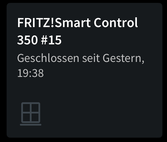

I just installed a FRITZ!Smart Control 350 (door/window sensor).
  • In the FRITZ! Smart Home app I can see the status very clearly, e.g. “geschlossen seit gestern, 19:38”.
  • In Homey, however, I only see generic values like Allgemeiner Alarm = Nein and sometimes strange timestamps (e.g. 1970-01-21 for “Alarm Zustandsänderung”).
:backhand_index_pointing_right: My question:
Is there a way to expose the actual open/closed state (with last-changed timestamp) in Homey, just like the FRITZ! app shows?
Does the integration already map this to a capability like alarm_contact or windowcoverings_state (and maybe I’m just not seeing it), or is support for this device type still missing in the FRITZ!Box bridge app?
