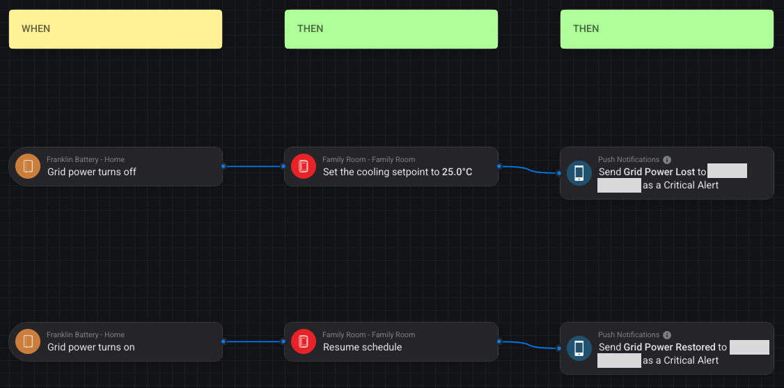

I just tested this flow, by manually shutting off my grid power, and it is not working. I got the notification of grid power loss from my Franklin app, but the flows didn’t trigger. I can’t really get more straightforward than this.
@Tim_Wilkinson as developer of this app can you provide some insight into what I am experiencing please?
Well this is odd. I did test this on my home and, at least then, it worked just fine. I’ll retest it next time I have the house to myself and a little time.
I quickly checked the code and it should be working. There might be a bit of a delay as it has to poll the Franklin service for the info. I assume your Internet and wifi stays up when your pulling the power?
Yes, everything stays up and running when pulling the main power. It’s not just the grid power on and off cards though. Almost all the other cards don’t work either, or as expected, which wouldn’t require you to pull your main power.

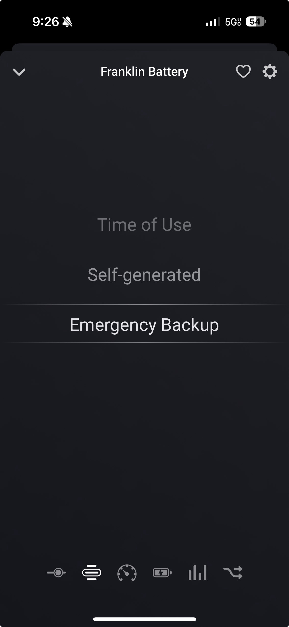

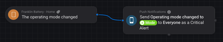

Excellent, happy to help test! Just installed the test version provided this morning. To perform just a basic test I am using this flow.
Then I am opening my Franklin app and changing the mode from Self-Consumption to Emergency Backup. What’s strange is, that it shows the mode change in the Homey App that reflects the mode I changed it to in my Franklin app, but it didn’t trigger the flow when the mode changed.

Retested the mode flow, and is still not triggering. I can see it change mode in Homey UI with a 5ish second delay, but doesn’t trigger the flow.

Okay. New version. I switched from flow trigger cards to device flow trigger card and that seems to have fixed my mode change test which uses a custom card. I’m still unclear why the Homey generic cards dont work though.
Can confirm that operation mode switch is now triggering that flow. Air high five!
