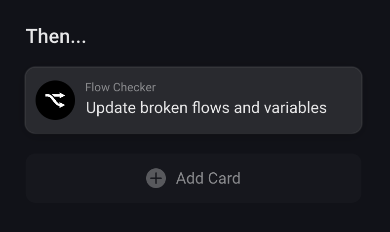

As your mentioning the device capabilities app it might be that variables are changing. I don’t know how the device capabilities app works. but what you can try is to make a flow and run this card:
maybe that resolves it self again

@martijnpoppen Thx Martijn. I have tried it and it worked!

Your then “Update” suggestion, as mentioned above, helped chgecking if my actions were already enough!

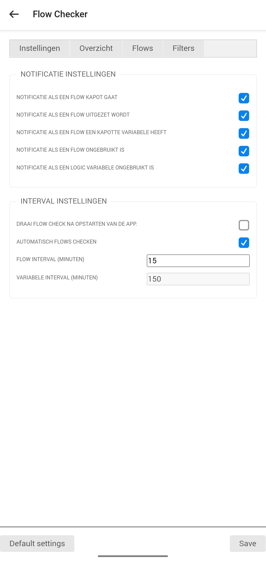

I also get quite some errors from flowchecker after a reboot. I assume this is because flowchecker starts to run before everything is avaliable. Therefore I have disabled the setting that flowchecker should run immediately after startup and only kept the interval
@Michel_Bos exactly what @josserke84 said: disable the flow check on startup;

However I have both automatic flow checker after startup turned off and automatic flows checker in the configurations of the app.

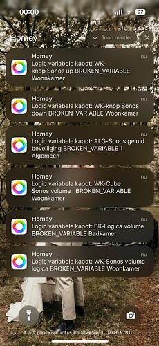

I also only get notifications (see first picture) of the variables that are supposedly broken, however, they just work and none of them is broken. If I do a 2nd run after the notifications via the start button then everything is fine again.

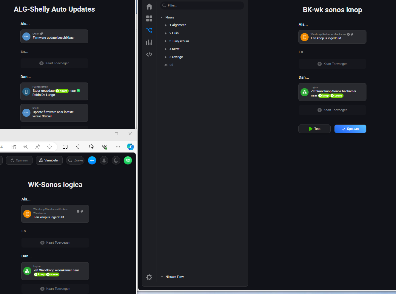

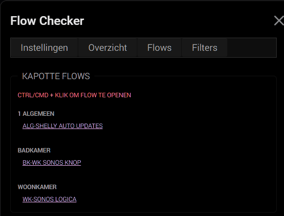

2nd thing I find strange, is that flow checker sees 3 broken (not advanced) flows which just work. even after rebuilding the flow and checking and replacing the variables it indicates that the flow is broken, but when using or starting the flow there is nothing wrong.

those 3 flows are broken

Do you also have the interval enabled in the app settings?
The update broken flows and variables flowcard is quite heavy.
If simultaneously also another check is running it might cause issues.
