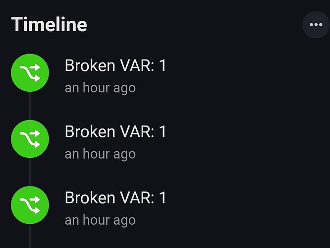

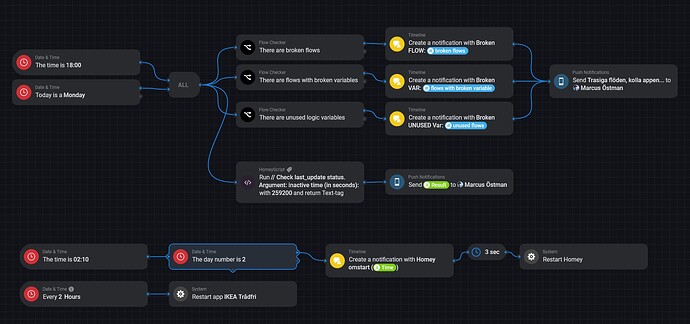

In the card ‘There are flows with broken variables’ I get response “1”. Problem is that I don’t have any flow called “1”. How do I troubleshoot this?
@Most were do you see that response?
This flow generates the response to the timeline.
I notice that app settings was also showing the response. But I can’t see any broken variables in the flow. It has a HomeyScript due.
Screenshot_2
@Most the tag you used is showing the amount of broken variables. Not the variable it self.
Ah, ok.
And are there any way I can find the broken variable?
No only the flow which contains that variable
