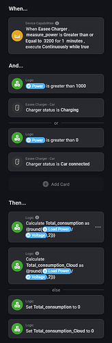

obrazek
So far seems to be false positives, eg. just random check, this one is supposed to be broken :
Will CLI provide more details ?
AATP :wink:
false positives on vars or on flows?
After I while, probably during scheduled check, seems screensavers popup again + now it reports 60 broken flows and 20 flows with broken variable. Those false positives were marked as “Device variable”. however they are fine.

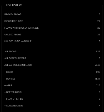

obrazek
After re-run…broken flows “disappeared” but flow with broken variables remains
obrazek
I installed again via CLI , will share details via DM…
@Sharkys this really feels like an issue on the Athom side with cached api calls.
I’ll check if I can fix that in a other way.

v1.26.5 (Pro 2019)
Zero broken flows, but I do have a few (20 to 30-ish). The other numbers seem to make sense.
No errors to be seen when running from cli. The ‘BROKEN’ array is empty
