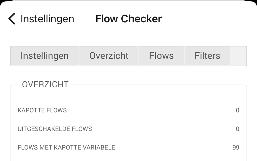

Did today a reinstall of the app (again), but that didn’t solve my problem.
I think mine Is broken than.
Homey can’t discover that a flow is broken and flow checker thinks allot of my variables are broken. Haha :stuck_out_tongue:
Yeah, it’s working again. No broken flows :slight_smile:

@iBosvelt also nothing at flows with broken variables?
I assume none of my flows are broken :slightly_smiling_face: I can try today if bbl works with a broken flow
FYI zero broken flows @ Pro 2019
I have dozens of broken flows, standard and advanced.
I also temporary disabled Chronograph to break a ton of flows.
The variables are the issue for me.
For me there are also no broken flows, because hp23 has a bug. It won’t show the error triangle anymore, so I think flowchecker won’t see it either.
I have at least 2 broken flows.
Yes that’s correct @Arjan-21
@Peter_Kawa same issue for older HP :frowning:
I’ll check again @Arjan-21 will send you some instructions tomorrow which might help :slight_smile:

@Arjan-21 I created a test version to debug BL vars. Can you install that version, trigger the update broke flows and vars flowcard and after that send a diagnostic report? :slight_smile:
It won’t fix your vars, but it will create some logging which might help me debug it :slight_smile:

It has some missing scopes, I’ll check how to resolve this.
@Arjan-21 the issue seems HP23 related. Created a webapi issue at Athom. WebApi v3 - createAppAPI - missing scope "homey.app.control" · Issue #45 · athombv/homey-web-api-issues · GitHub
Don’t know why it works for others :man_shrugging:
@Arjan-21 one thing we can try :smiley:
  • Go to: Homey Developer Tools
  • clear the input field
  • paste: Homey.apps.getAppSetting({ name: 'variables', id: 'net.i-dev.betterlogic'})
  • click run
@martijnpoppen When I add it in the playground, than I will see (I think) all my BL Vars.

Thanks, then it’s really a Scope related issue on the HP23
I reported it on Github and Slack. Not much that I can do for now :slightly_frowning_face:
