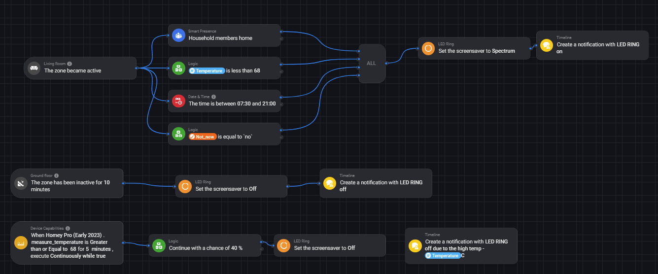

Is reported as an error anyway, I had that too. I assume that during migration all 3rd party screensaver flow cards are automatically replaced by Athoms flow cards. You only need to change or replace the cards and then save the flow, after that the flows will no longer be detected as broken.
Please see my comment on the screensaver… or it’s related ?
Thank you, problem is that some of the flows were created already on HP23 ;-( Also checked them and re-saved, didn’t help.
In that case I Will disable the screensaver check on HP23 as it probably causes issues.
Could it even happen that screensaver is missing / using incorrect one on HP23 ? I just wonder, on HP19 that was different situation I guess. I’m just surprised I got it suddenly this morning first time.

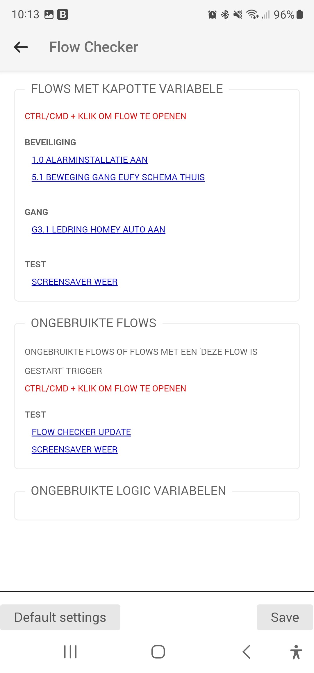

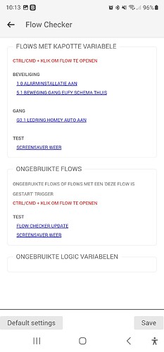

Hi Martijn, on my hp 2019 all flows in which I set the screensaver to “weather” are marked as broken variable. I’ve created a simple flow to test this

@Peter_Kawa yeah the broken check is broken ![]()
Athom made a change for webapi v3 and i tried to implement it last week but it gives massive memory issues.
Im waiting for a response from them
So the check right now does nothing so it will never fix itself thats why you see a wrong number there.
Hopefully a fix is available soon ![]()
