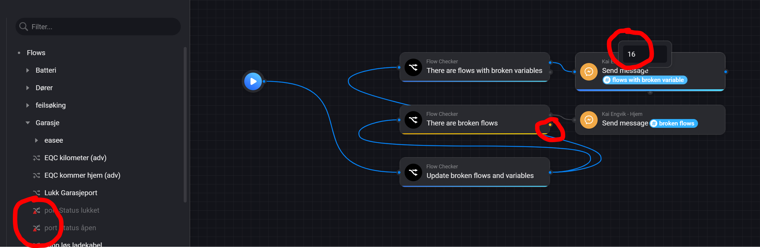

trying again now :sweat_smile:
you can force a check with the “Update broken flows and variables” flowcard
The new try tells me 16 broken varables. Is there a way to identify these flows? And the other card, should it not have detected the two broken flows? The previous version actually did.

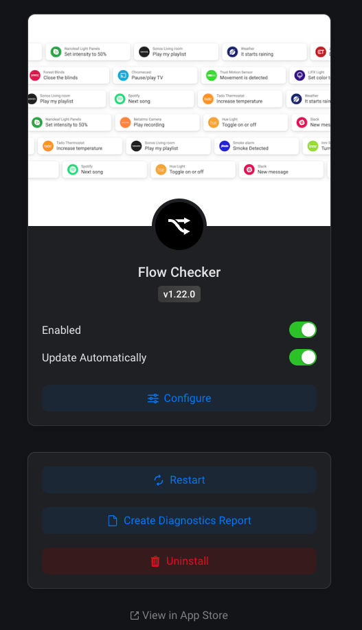

Yes in the app settings there’s a overview with what is broken:
Click configure:
See flows and info:
nice, but I reviwed a couple of the 16 detcted missing variables flows, but did not find anything wrong. How is the detection working? What does is check?
It checks all flows and tries to find the variables inside it. App variables, device variables, logic var, better logic vars etc.
It creates a list and it cross checks that and checks whats wrong.
But do you see that broken variables also coming back in the overview in the app settings?
