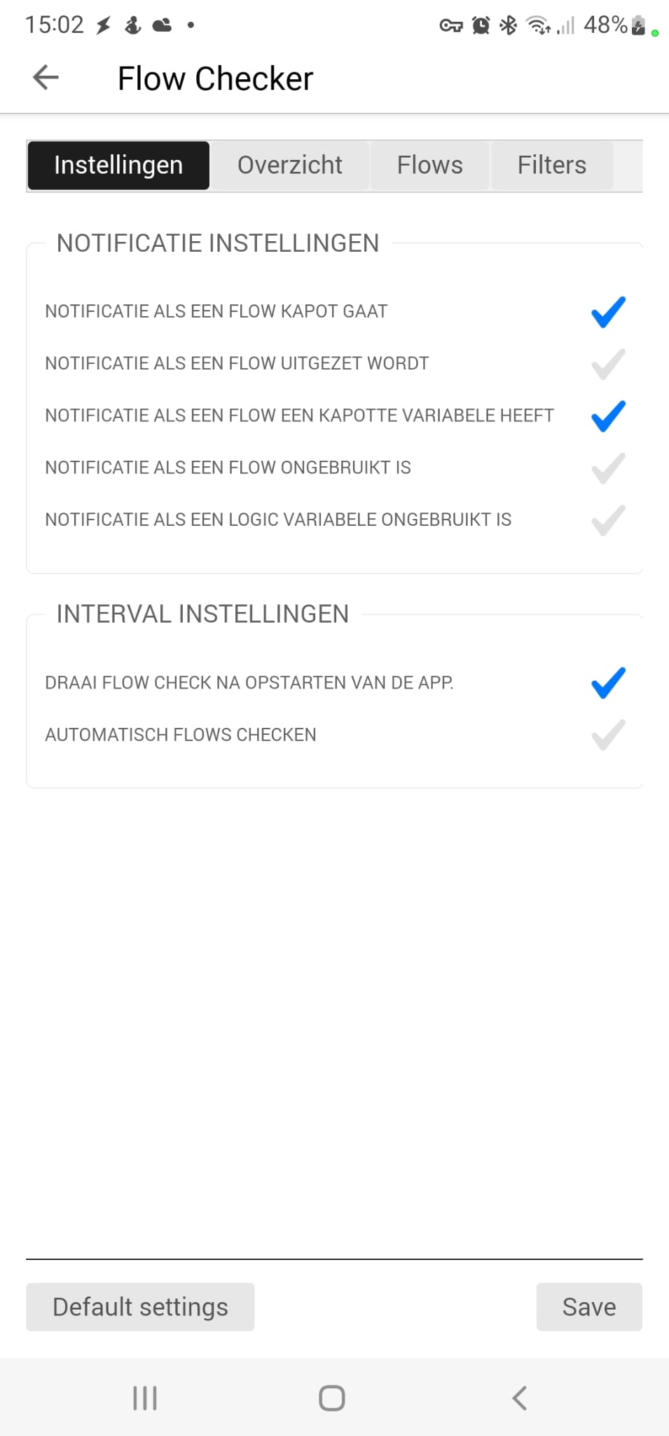

The last option “automatisch flows checken” should be ticked.
You can force a check with this flowcard:
(in English: Update broken flows and variables)

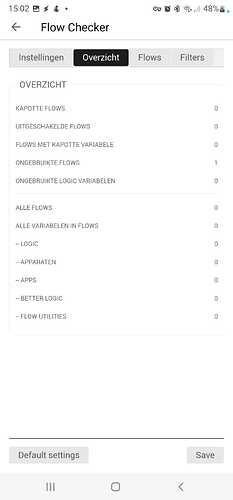

That’s weird, i think i put in the wong picture, here is the correct one.
And i added a flow now, running every 5 minutes with “update broken flows and variables” and did already a test-run which did nothing, will look again in an hour (then it has run multiple times so i should see something then).

I still have only 0’s on the list, only 1 ‘1’ (for a disabled flow)
Homey FW 8.0.1

I see now my variables are counted [as unused?]
Flow Checker 1.18.1
