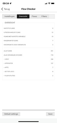

I have a few issues…
the apps reports of 1 unused logic value, but the logic value reported is deleted and not present anymore in the logic list, after deletion (a few days ago) the app keeps reporting that there is 1 unused logic value, but there isn’t…
the app reports several unused flows, when i check they are not all correct, all reported unused flows are ‘normal’ flows
Some of the unused flows are started/triggered within an advanced flow, but the app reports them as unused, so the used check in advanced flows is not working correctly.
I run app version 1.18.3, the last one, restarted the app several times, but these ‘faults’ do not go away, when i delete an (really) unused flow the app removes it from it list, so it does work.
I created a diagnostic report with id: d8b1d79d-2c04-4045-b48b-d1d06edf2000
