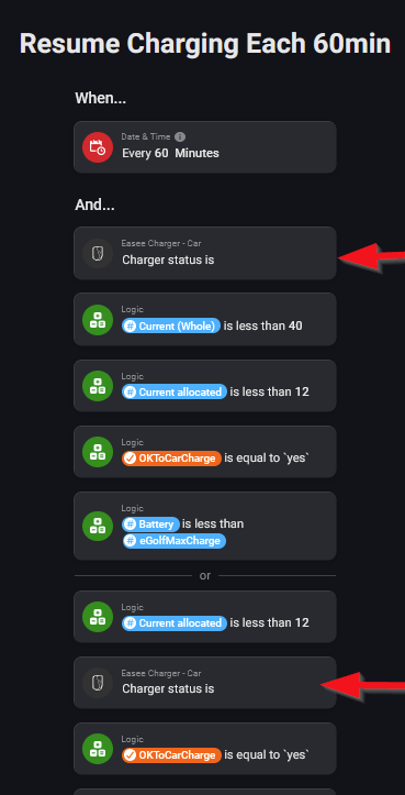

Hi @martijnpoppen , another challenge for you and your fantastic app :wink: Do you think it would be possible to report such broken flows ? Something has happened with those conditions marked (we discussed in the relevant app thread) and flow are broken - but it’s not reported and the flow itself almost do not indicate any problem until launched / tested - then it throws error :

Related flow :
Fixed flow :
obrazek
Diag. : ebea0af4-5e61-4575-8044-439d342bb44c
What is dangerous about that, without reading forum, I would not notice it’s broken… now I have to search all relevant flows manually and check. But thinking about those that have no idea…

@Sharkys floechecker wont see those cards as broken as they still have a value. However that value is not in the manifest of that app.
I could check if a flow could be tested. Theres a option for that. Not sure if that will fix it.
I can have a look this weekend
Thank you Martijn, just in case it makes sense actually. Not sure how many such broken flows could appear for others as it’s linked with specific app / development change that triggered that. So if it’s unique, it is probably not worth the effort. Richard already explained how this happened …

"broken":boolfalse
"triggerable":booltrue
Btw the condition I see in the GUI as non existing, is displayed fine …
"id":string"chargerStatus"
"args":{1 item
"status":string"Charging"
I’m afraid such errors would be probably undetectable…
@Sharkys you have to many flows :stuck_out_tongue:
Yeah it is undectable. Has the capability is valid and has a value. Unless the app creator keeps it and uses deprecated. Then Flowchecker can check the deprecated cards

Indeed, but this was un-intended error, already fixed in the meantime, after I realized actually what one of the user wrote, I think at that time also developer realized it as well… it’s already fixed in the next version, yet - it’s pretty un-detectable/nasty error . Possibly also something that would/could be addressed by Athom as maybe that should be prevented “by design” but not an expert here … anyway, maybe will not happen again (like with other app, other developer).
** update ** … I checked again, it’s not fixed yet, I will fix it manually then.
