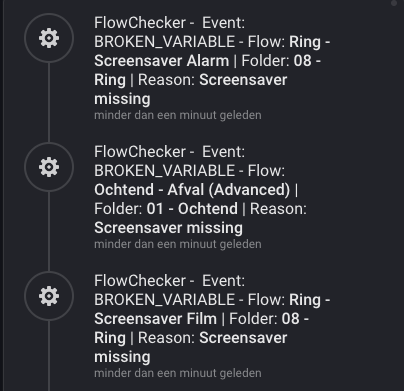

2. NEW: add reason to broken logic (see image below)
Reason types:
  • Logic variable
  • Device variable
  • Screensaver missing
  • BetterLogic variable
  • Flow Utillities
  • Broken app

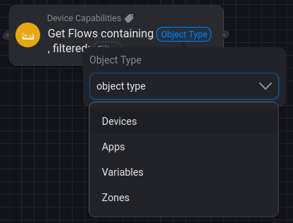

There is indeed ‘a’ way @Homey2, but don’t know if it is useable for your ‘clean up’ round.
This spits out flownames & their ID’s, you can filter on object type and (part of) names, like an app, or a brand, whatever:
Screenshot from 2022-12-13 23-25-54
Screenshot from 2022-12-13 23-32-52
Maybe the output can be filtered to flow ID’s JSON only, which makes things easier to batch delete them, using it as array inpunt of a script.

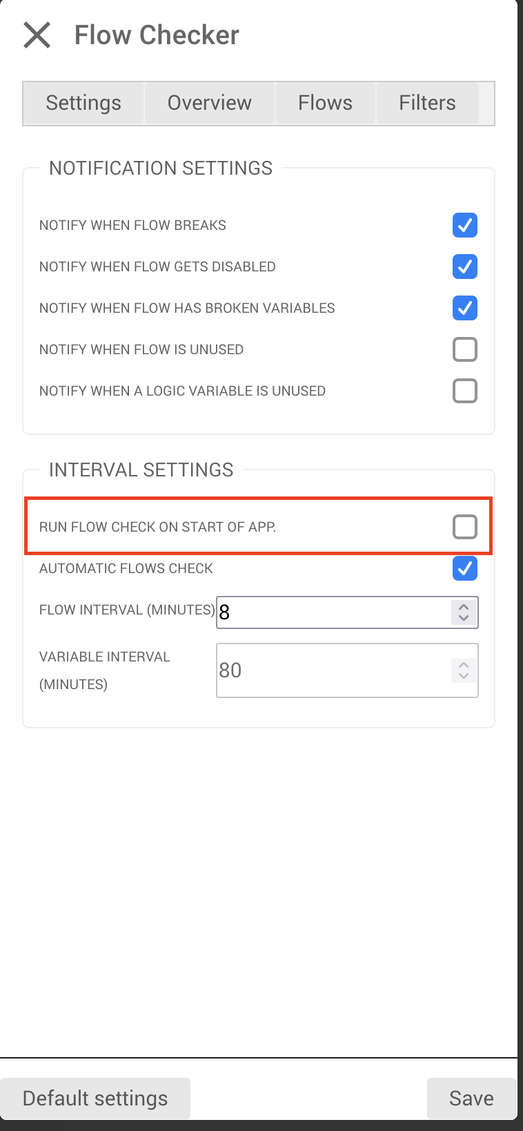

@Ria_Banis do you have any flow running at that time which is restarting something? Apps or Homey?
If thats the case I would suggest to turn off the auto start of flow checker.:
I think that’s what smart home is right? :wink: (time consuming)

Hey @Twan_Veugelers
FlowChecker checks once and immediately marks something as broken.
To have a second check it will run all the checks again, which are quite resource heavy.
It’s not possible to run it only for a specific app.
In case of the variable check:
  • get all flows
  • get all advanced flows
  • combine all cards
  • loop trough all the cards and perform checks.
something you can do to prevent false positives. Is disable the following checkbox:
