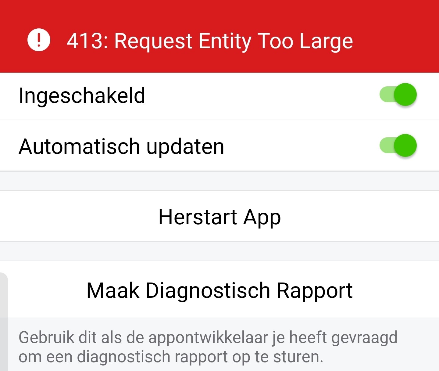

Hi Martijn,
April 22nd I installed firmware v7.4.0-rc22
The memory usage of Flow Checker increases.
The app was auto updated to v1.16.6, 2 days ago.
I didn’t change anything in the settings for a long time.
I wanted to send a diagnostic report, but I got this error message.

It seems the report exceeds the file size limits set by Athom.
I didn’t see this error msg either yet.
Did you get any message at all?
I assume not b/c it did not return a diag ID.

Hi Martijn, I tried to send it, but now a 413 error pops up again…
The reboot helped, the memory useage is back to the usual level:
