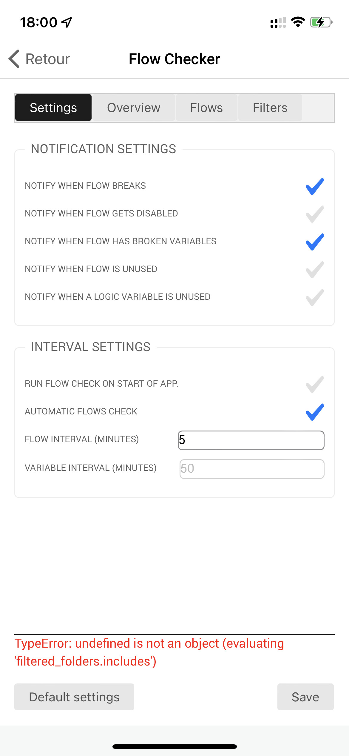

@martijnpoppen same thing for me. Reinstall and restart multiple time does not work.
Homey v7.2.1
Report: d6fa3dc4-6db7-4230-a3c8-8e01876a91fd

@sebyldino made a fix. Can you install the test version (link above) and check if it works for you ? :slight_smile:
Same after install. I restart the app and it works.
