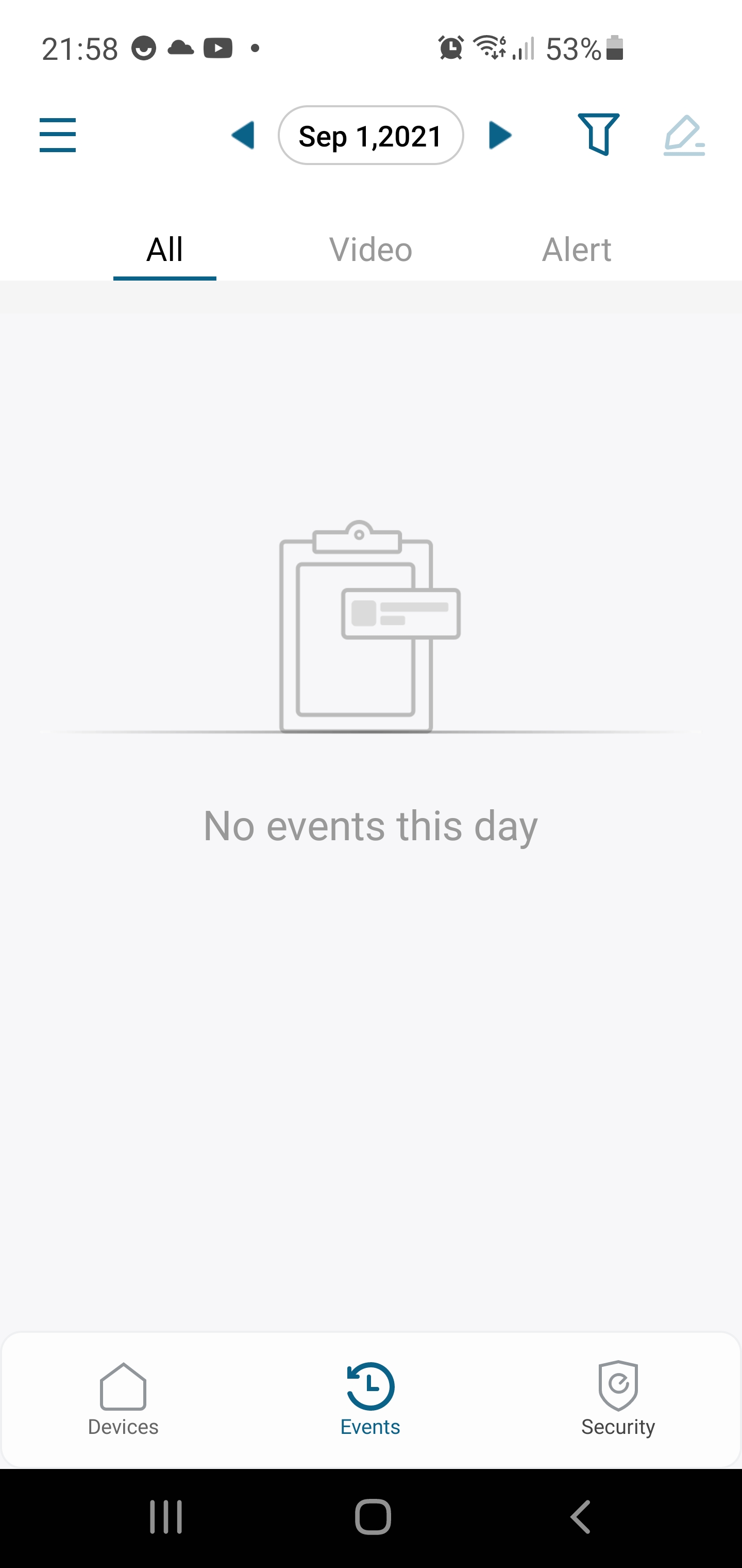

hello I have a eufy doorbell, I made a flow when someone calls you send the image to the google hub, but the image is not saved in the original eufa application and you can not check the recording who called
Hey @Tomek_D ,
The integration in Homey doesn’t store images to the offical Eufy app.
The Homey app allows you to integrate Eufy with other smart home devices.
I hope I understood youre problem correctly :slight_smile:
Note: with a doorbell press there’s not always an image available.
I mean that normal, after pressing the bell, the image is saved in the eufy application in the Events section, and after taking flow and uploading the image to google nest hub, the image is not saved in the eufy application
@Tomek_D can you maybe share an screenshot of the place where you would expect that screenshot? :slight_smile:
at this point there should be a video of someone ringing the doorbell
