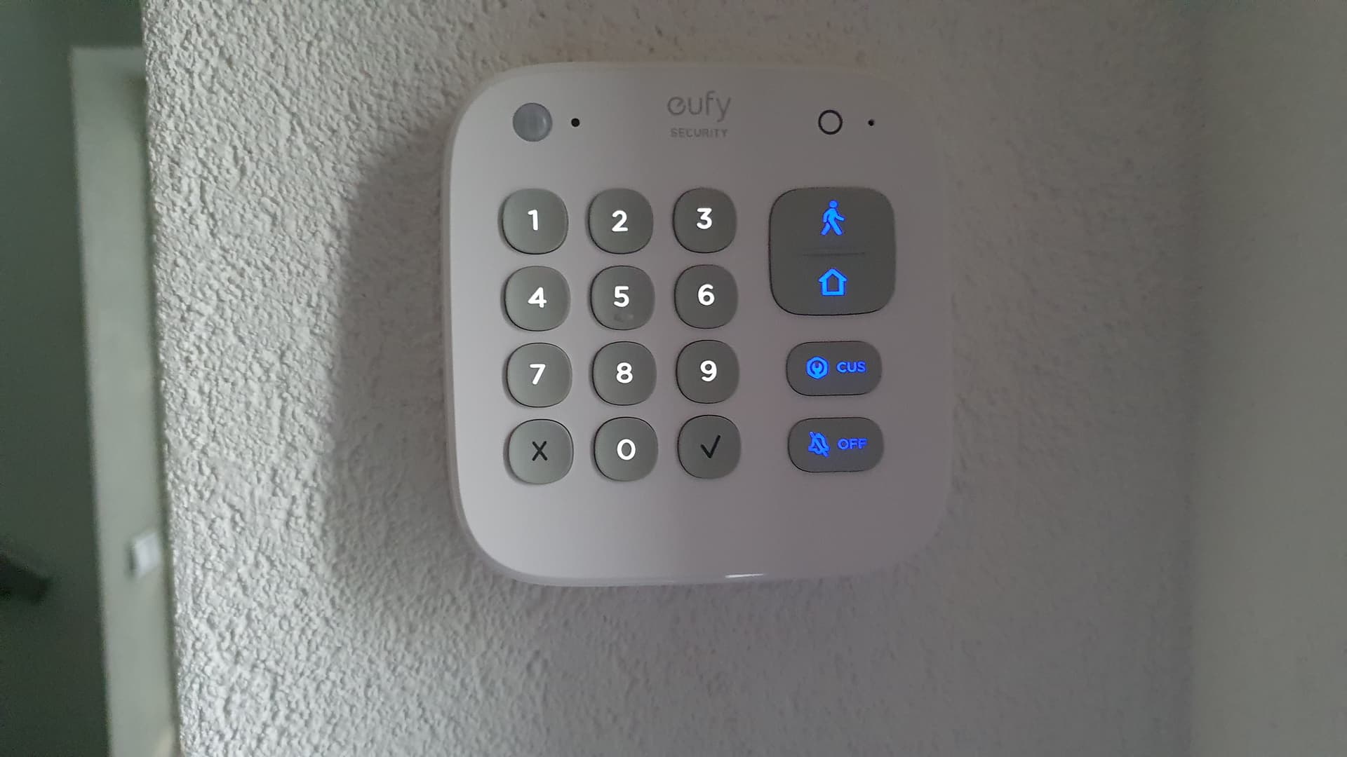

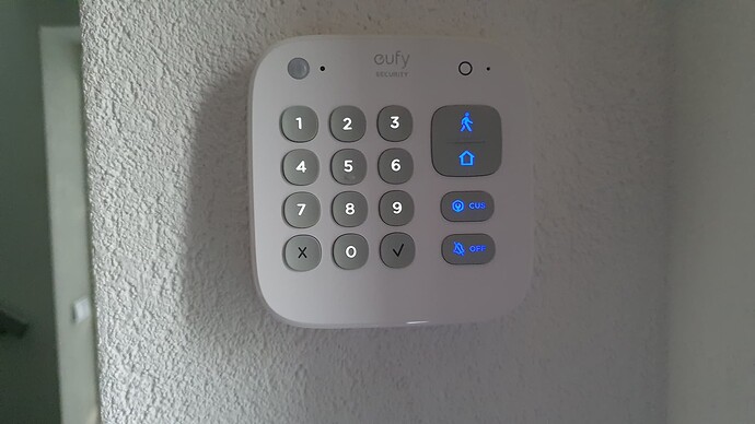

With the latest updates, there have been issues with the various modes.
When I enable a mode via the Eufy app, it is not recognized as such in the Eufy app in Homey.
The only mode that is recognized and therefore works well is the home mode.
I also had to check all my flows and set the right modus for it again. Not sure if this was ment to be but I did not see that right away but that came to my attention by accident.
When I select another mode than home with homey than all modus lights are lighting up blue.
Diagnostic rapport has been sent.
49fb8732-4f3e-4df5-b269-874933e68592
Thanks.
@Heula I’ll have a look!
@Heula found the issue. Will make a fix ASAP :slight_smile:
Something went wrong after update 2.11.1
Thanks :+1:t2:
New app update (live: 2.11.3):
Changes:
  • FIX: Homebase couldnt find EufyP2P service.
CC: @Heula
@martijnpoppen , after restarting the eufy app for homey it is all working fine again.
Thanks for fixing this so fast. :+1:

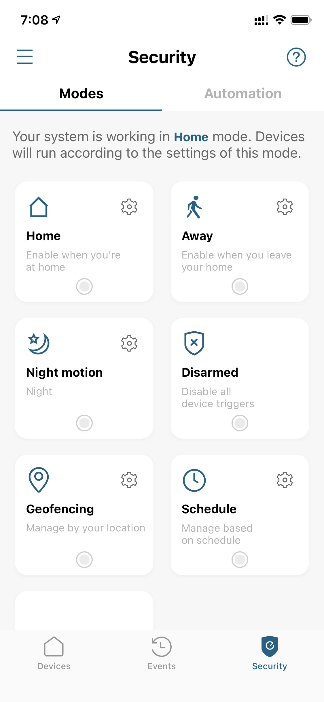

Why say this eufy app? I don’t have any automition only in homey and I home at the moment and if someone in home no action.
and the app security page looklikeas if nothing was turned on.
If I change manual or homey modes after few seconds app say automatically switched security modes… but why?
@Felho I don’t know why that happens.
Can you send a diagnostic report?
You can do that via:
More - Apps - Eufy Security - Settings wheel right top - send diagnostic report
1013399b-96c4-4059-9f81-af691fafa7e5
