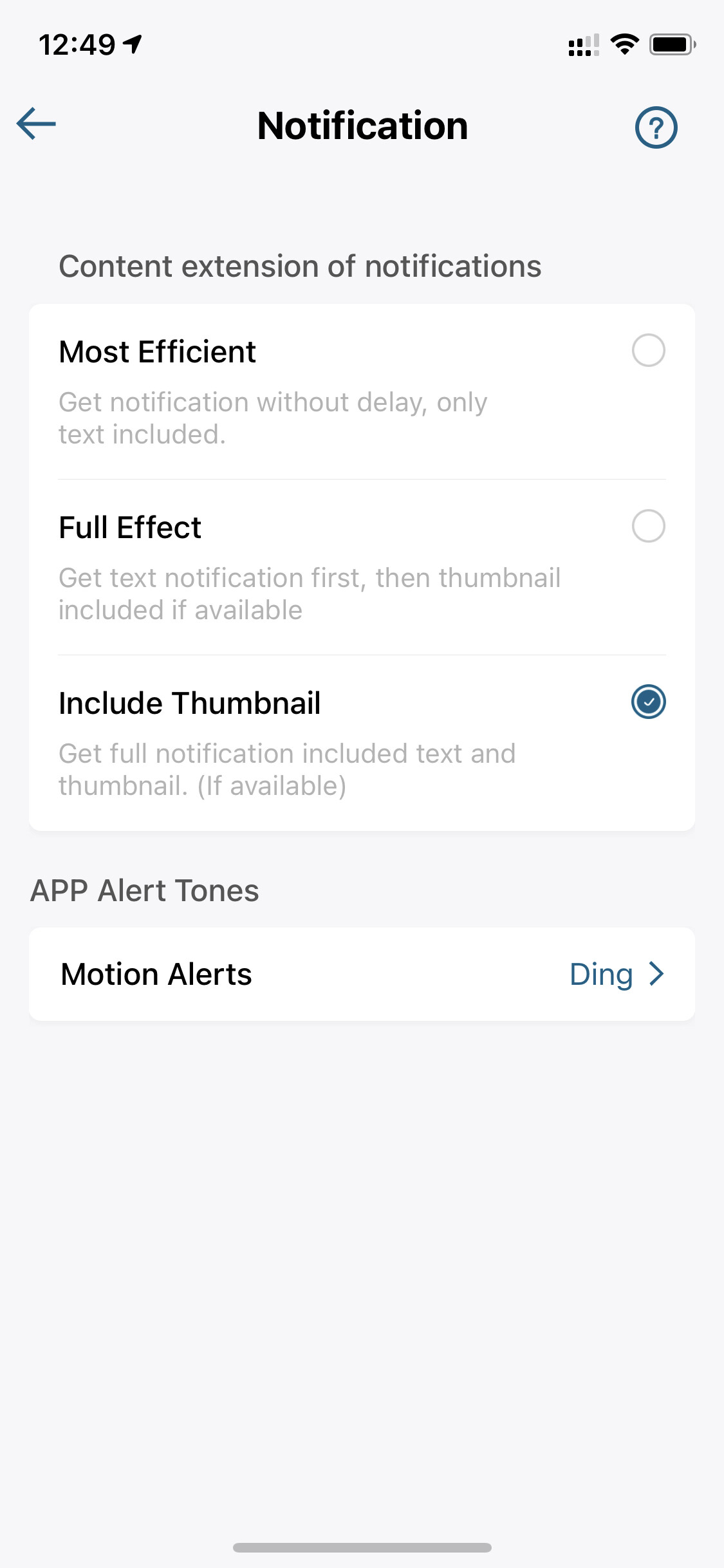

2c32e20f-da21-4509-a836-33fb5efdd040
the offical app send notification but homey and telegram no
@Felho got your new logs. I do see Person detection. So it does work. But i think you have to change your flow to Person detected instead of motion detected (or both).
In your flow you have the trigger motion but not person : Shared Flow | Homey
What you also can do: Select the generic motion card : The motion alarm turned on
This will trigger on anything. So it’s a catch all. This will also activate your zone.
You can enable this per device in the device settings

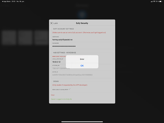

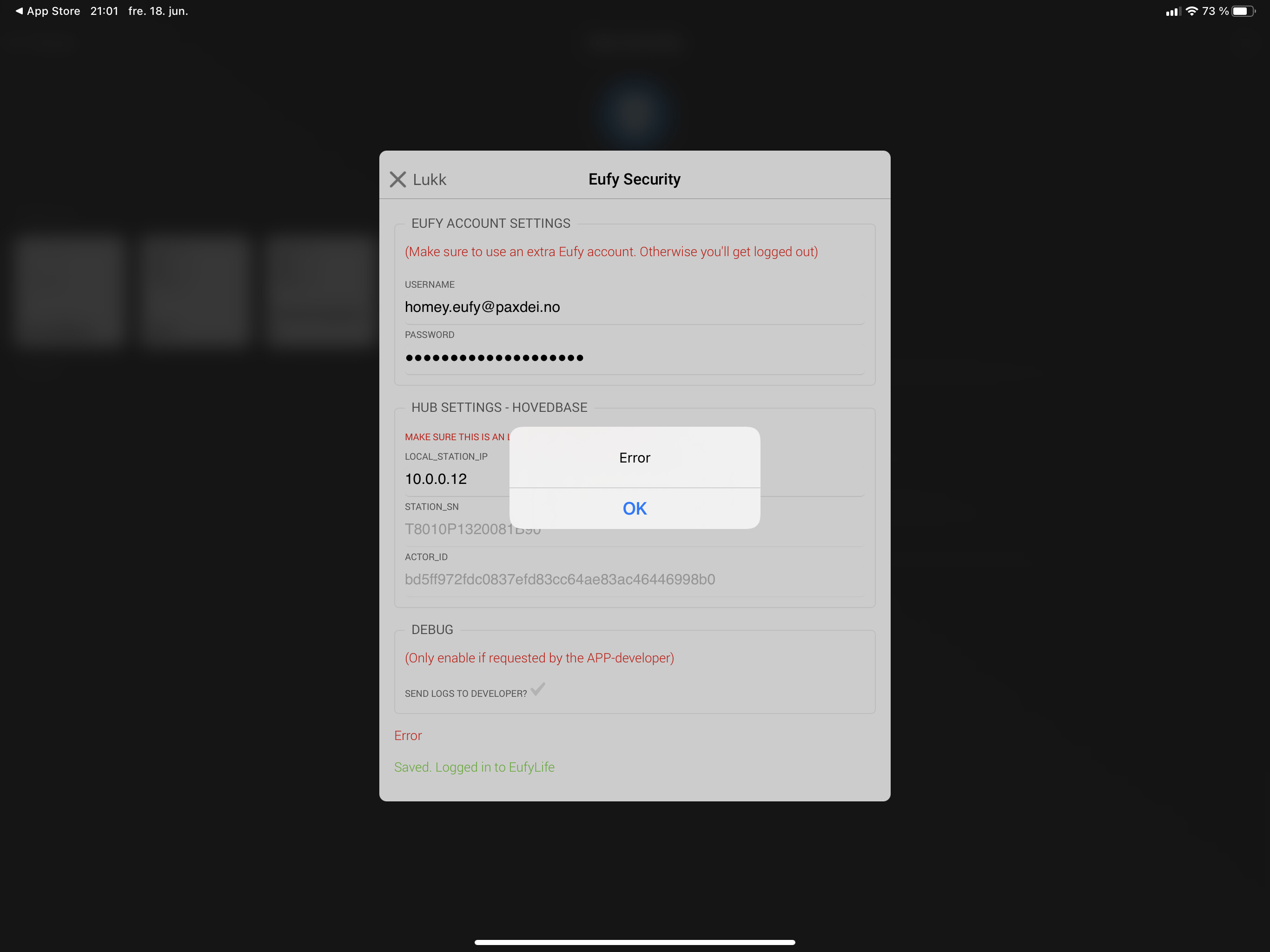

Hi there, new homey user here. I seem unable to use this app. It worked when I first set it up, but now one day later I can not change my guard mode. During my sleep last night it seemed the app also turned off all my cameras. Now nothing works, just the login on the settings page. Any help is appreciated.
My setup: homebase 2 sysver. 2.1.7.2h, subsysver. 1.3.0.9
Correct internal IP address set, secondary admin user.
Homey pro v.7.0.0
I get a timed out pop up after 30000ms

After several tries in the login page, it now seems to work. I tried rebooting both eufy and homey several times. My eufy got a new IP address and when I changed to the new address I got a couple of error messages (something about unauthorized access), then I tried again and got the one I post here, but on the next try the app started working again…
diagnostic report code: c25f4205-6292-4d0c-924f-f4026d4fc96e
