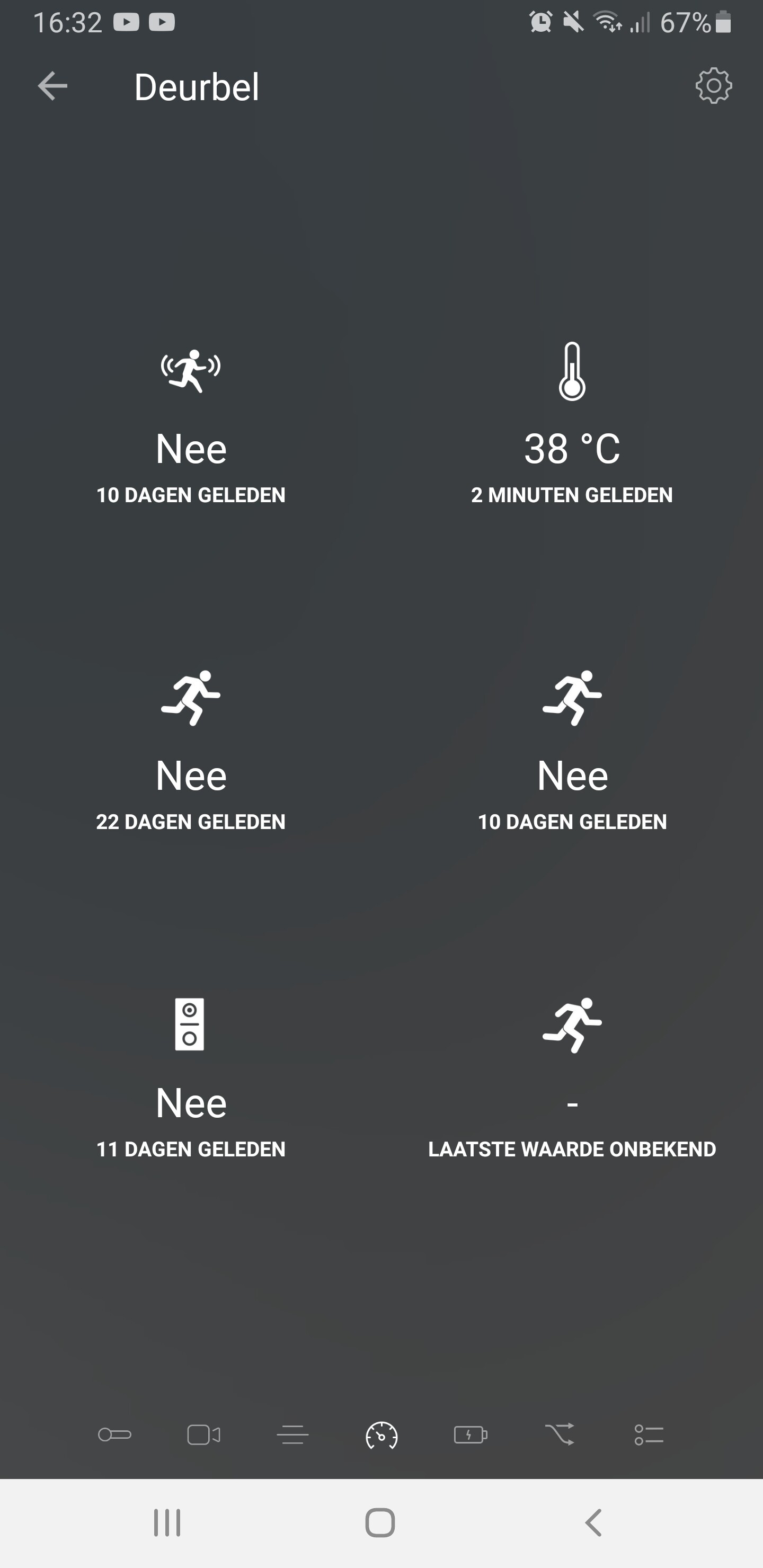

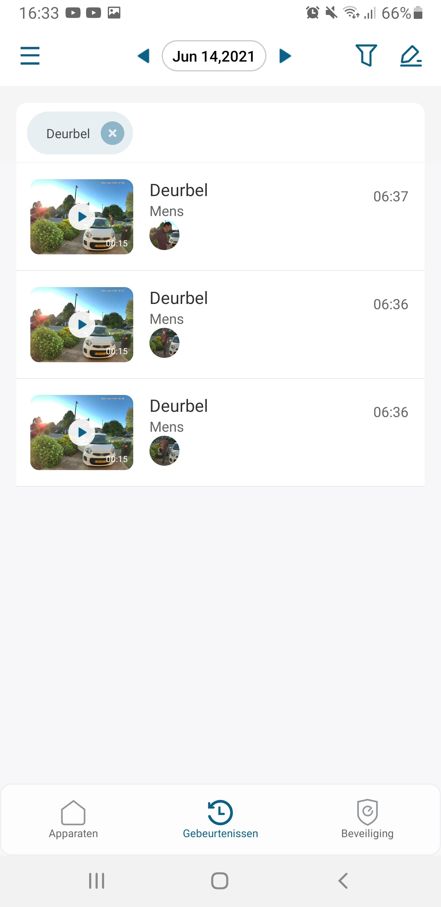

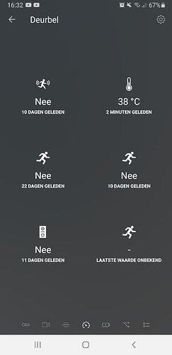

Temperature updates, the other values don’t (and I really did get motion in the app).
I logged in once again and I tried the experimental app.
@Glenn_Dijkstra Will take a look.
Didn’t get your report.
Can you send it via `More → Apps → Eufy Security → Settings wheel right top → Send diagnostic report
@Glenn_Dijkstra Ah I see you enabled reporting in the app settings. I already see what’s going wrong. Your Homebase is set to a public IP. This should be the internal IP of the Homebase. See FAQ Q4 [APP] Eufy Security - #4 by martijnpoppen
Ah, thanks! It did work for weeks, strange… Anyway, thanks!
