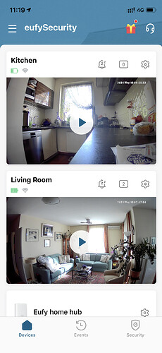

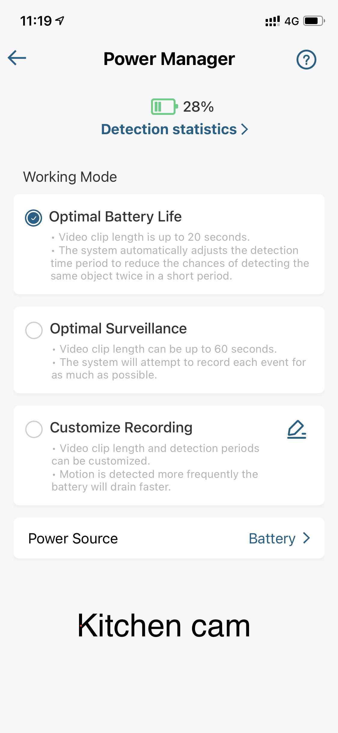

Hi my cams power different % in original app and homey why? And it’s normal the kitchen cam very fast low because the cam set same as living room?
@Felho check FAQ Q5: [APP] Eufy Security - #4 by martijnpoppen
So Will also be fixed with the rewrite
Yep thanks
