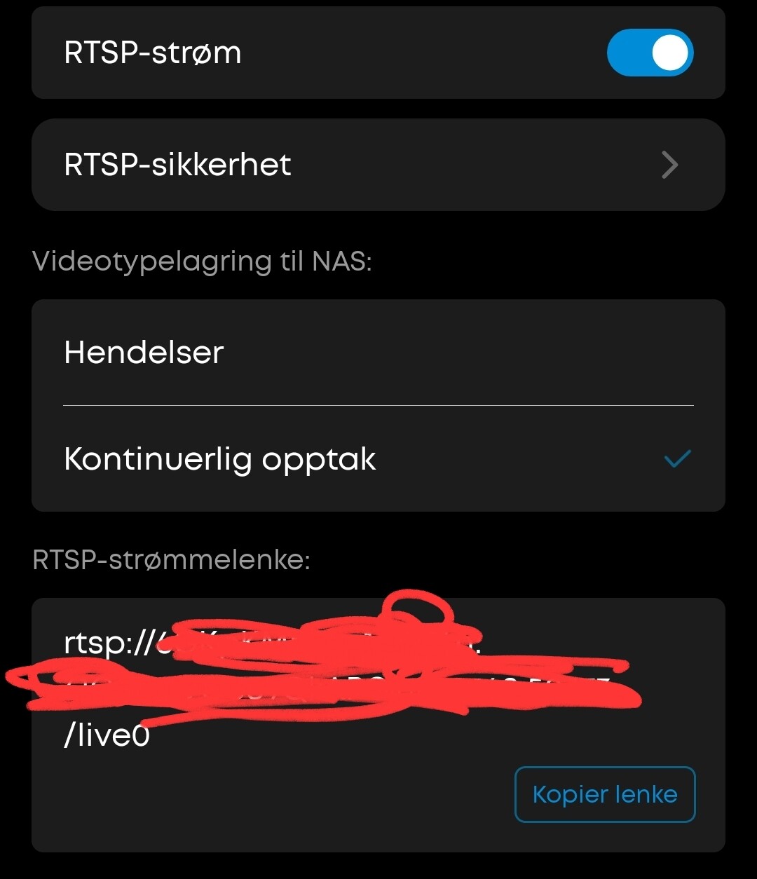

For my Eufy camera, I have the option to activate rtsp stream, and I get a URL for this. This works great on my local network through vlc, and I have even set it up to host through go2rtc on a raspberry pi to create a widget on my home made dashboard.
I see from Homeys documentation that rtsp is supported.
Should this not be possible to implement in your app, with the option to add username and password in the app settings? At least for local functionality?
@Torbjorn_Melbye yes should be possible and I am working on it
I’m close to a test version.
I expect somewhere in the comin 2 weeks
Perfect. Thank you :grin:

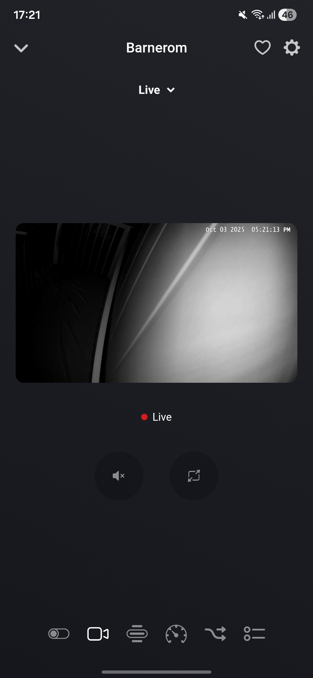

Well that was quick :sweat_smile:
@martijnpoppen works like a charm
@Torbjorn_Melbye nice!:raising_hands:t3:
