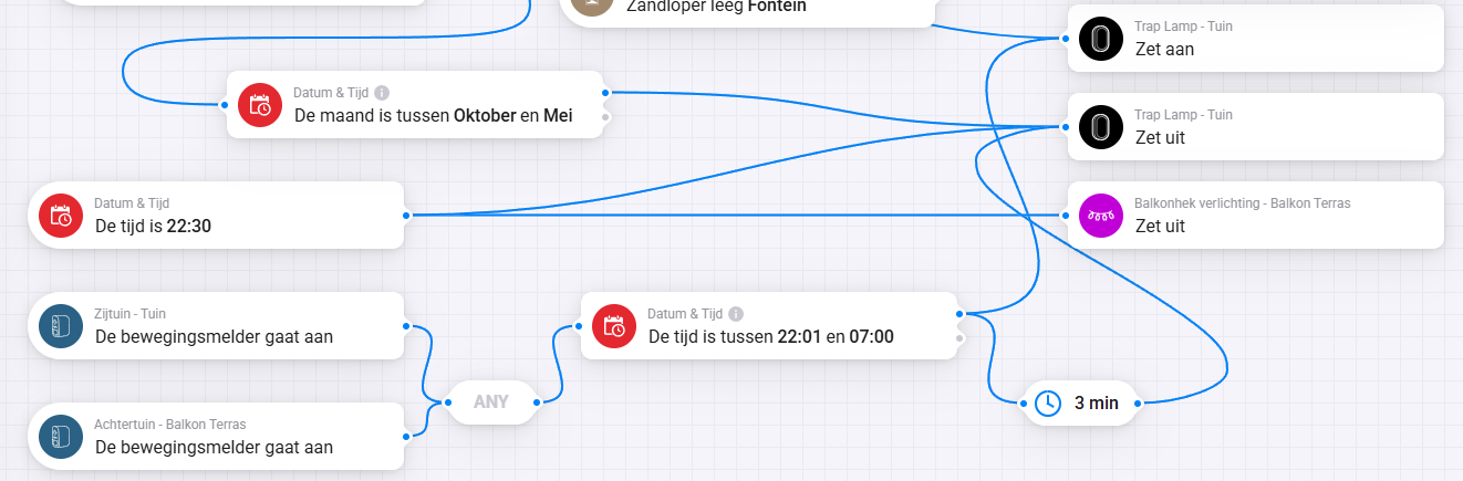

This simple flow doesn’t react on the detection on the Eufy camera. Why not? In the Eufy app itself, it works fine.
I can put on and of the light on the camera from within Homey. That will react on the camera :smiley:. There are no snapshots from detections on the camera “snapshot” in Homey.
@Ruud_Silvertant see FAQ Q1 :slight_smile: [APP][Pro] Eufy Security - #4 by martijnpoppen - Apps - Homey Community Forum
Settings are like #4. All pushnotifications are on. In Homebase3, known persons notifications are out-marked
@Ruud_Silvertant keep in mind that “beweging” is not the same as “person”. Eufy most of the time recgonizes persons.
if you want a card that triggers on anything make sure to enable generic motion alarm in the settings, it will give you a extra flowcard and zone activity
This was the solution for the detection to switch on the lights.
But still no snapshot visible in the Homey objects.
