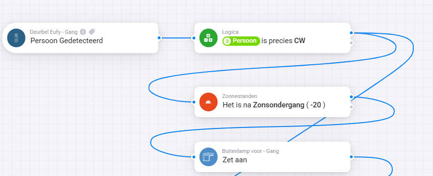

Can you elaborate on this a bit more?
As I asked before, I would like to have my door unlock when my e340 detects a known face/person. I dont understand the language that is on your flow :stuck_out_tongue:
@Aldin_Adam_Jerjas Here’s a english version:
The person tag is part of the first card. (you can see the tag Icon).
So you could check the name there. The name is the same as you set-up in the Eufy app.
but as also said in my image, Eufy does have false positives. Unless I have 5 brothers in my town :wink:
@Aldin_Adam_Jerjas @martijnpoppen already explained it in englisch.
For your info.
Person detected
Person is exactly CW (CW is the name i did give the person)
After Sunset -20 minutes
Turn on a light.
