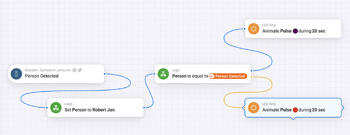

Hi @martijnpoppen, I have some issues with the person family recognition from my Dufy Doorbell S330 Dualcam. I have red a lot about this issue in this topic but the familymember who are recognized are not showing up in Homey. Other notifications like “Person detected”, “Motion Detected”, etc, are working fine.
I already have done the following actions:
  • Reinstall Eufy app and activated with guest account
  • Push notifications are enabled.
  • Created and sent a diagnostic report (634e802e-a41f-4065-8fa9-17986ea235b5)
Could you please check the report?
Thank you in advance!
Robert Jan
@rjvandenbovenkamp i do see a person detection with name Robert Jan
Also replied on the report
But what isn’t exactly working?
@martijnpoppen
Thank you for the check and quick reply!
The name “Robert Jan” is correct :slight_smile: but II do not see "Robert Jan in the logreport but always only “Person Detected”.
I have created a flow with a variable with the value “Robert Jan” but the flow is not getting the name of the person.
Here is my test flow (just for testing the recognition :slight_smile:
The Led keeps giving a pulse in red.
@rjvandenbovenkamp can you run a flow like this?
Person Detected → Timeline notification with person tag.
Because now you’re checking a String value to a boolean value, that will always be false :wink:
@martijnpoppen
I made a test and it is working fine now!
Thank you very much!!
I see what I did wrong with the strong/boolean value :slight_smile:
Thank you!!
