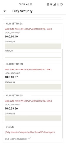

I have not set up any public IPs in the app, see:
(blanked the station ID etc for security reasons).
Not sure where the public IP you are referring to is coming from then?
@Yeebo For me it looked like the 10.x.x.x.was a public IP as I see timeouts on those addresses. Can you verify those IP adresses are still valid? If the Eufy camera has not an fixed IP it doesn’t work
Hi @martijnpoppen ,
They are part of the RFC 1918 (RFC 1918 - Wikipedia) and completely valid to use internally :slight_smile: I can ping all devices from the VLAN Homey is in and the IPs are set statically via a DHCP reservation.
