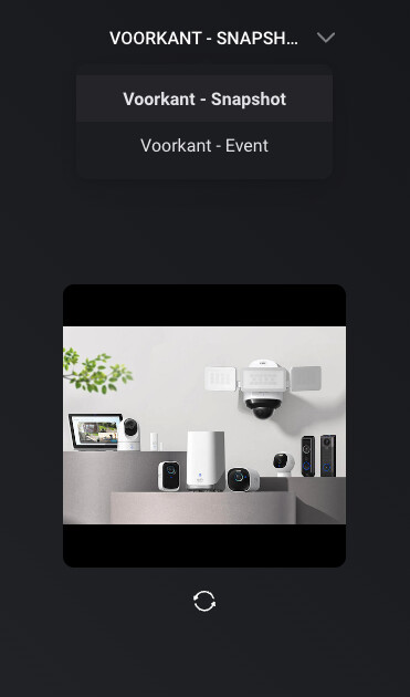

tonight i tried the “snapshot” feature again, it seems like it is not updating the “last snapshot” for the camera in the app. But when i send the snapshot as a message to the phone, it is the correct picture. Is this the correct function? If yes, is it possible to “override” the last picture i see on the device? If no, suggestions to what is wrong with my setup? Regards Marius
Hey @Marius_Stensrod
That’s strange, even after refresh?
And maybe stupid question, but did you select the proper image with the dropdown on top? :smiley:
@martijnpoppen , Yes, after refresh and using the proper dropdown.
But there is development, all of the sudden, the image did update. And now it function as it should, without me doing anything else. Sorry to bother you with a latency/server/host issue that you can not do anything with.

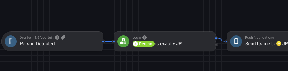

Does someone have an example of a flow recognising a person? I tried this but it doesn’t work
I have a HB3 and doolbell and camera that supports it. In eufy app it works.
