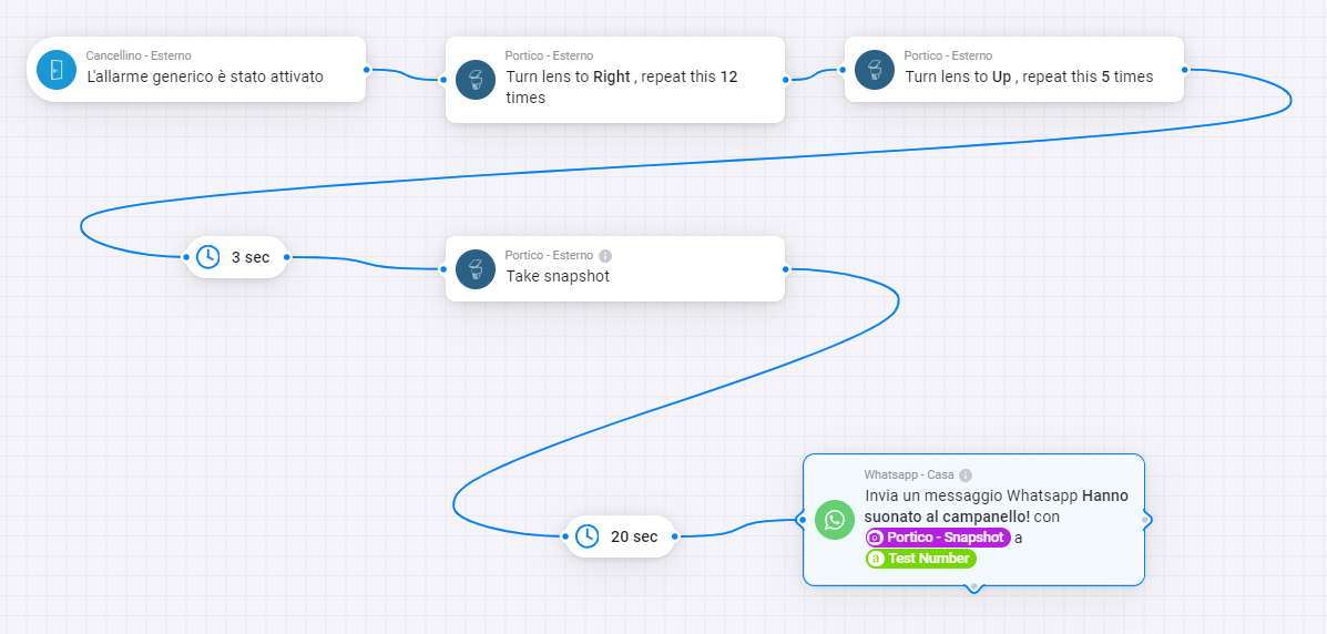

Hi @martijnpoppen, I was trying to use the flow card “take a snapshot” through my s340 to send it via WhatsApp. However, it seems like it repeatly sends the same old snapshot. Can you please help me?
Report: f5d1eb7e-5227-4bc6-862c-fbc8be0d9e25
@Luca_Lorenzi can you try a repair of your Homebase and after that a restart of the app?
@martijnpoppen now it worked but it is not 100% reliable. At first try it gave me a grey snapshot, the second try it worked. After the second try all my eufy device went in error and after they restored by themself the snapshot feature worked again.
Report: f0bbcccb-3352-4497-9717-a8b631f0d68b
This is the flow:
The delay card is there because I thought that the camera was not able to process the snapshot in time.
@Luca_Lorenzi correct, in the logs:
⚠ The app has crashed.
Memory Warning Limit Reached
the snapshot feature is really heavy as it opening a stream, i’m working on making it better, but not there yet :confused:
