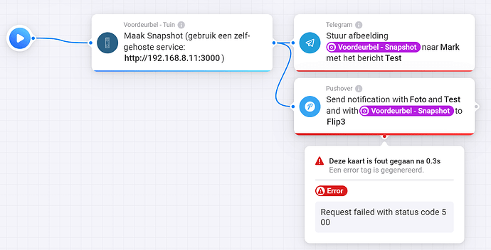

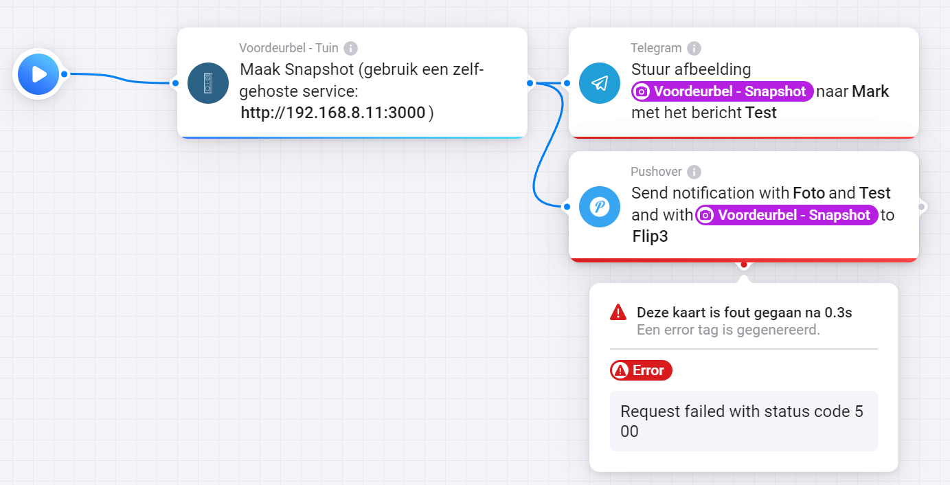

Some thing is wrong…
What I have done:
Installed and running the Synology NAS on 192.168.8.11, with the image on port 3000.
When I access the URL via a browser: OK
On my Homey, I checked the box for snapshot.
Subsequently, I encounter the following error (see screenshot).
Rebooted everything, but unfortunately, the error persists.

@0burner0 can you try the cloud snapshot? As said in Q13 i’m not giving support on self-hosted setups
Can you share your Docker setup ?
Eg. port settings mostly :
obrazek
Also you did open it on your NAS firewall, right ?
Came home from work, and it worked!
Did not change anything, but thnx for youre help
