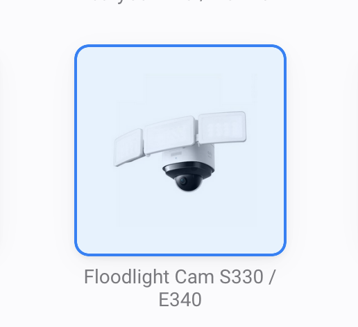

Hello. I am having trouble getting my Eufy S330 wired doorbell added to homey. The battery version is supported, but is the wired version support?
@Eric_Nelson i dont think the wired version is supported.
Its not available in EU as far as i know
I only support EU devices
Okay. Would the battery/wired E340 video doorbell which can be connected to the homebase 3 work?
I have been able to connect my other eufy security cams, and excited to start creating for flows for them. Just want to get the doorbell in the loop as well.
@Eric_Nelson i think the wired s330 might work. But needs implementation first
The S330 with Homebase 2 does work (battery version
E340 also works :slight_smile:
Great. Thank you for the help.

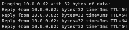

Thank you but that’s weird Martijn… IP is 10.0.0.62 (DHCP static)…
from Homey … (and I checked also ping yesterday)
Homey
From PC …
PC
Turning on-off via Eufy APP works, turning on-off via Homey Eufy Security do not work… also when I turn on via Eufy APP, the state is not reflected back.
In the Homey log I see :
Server HTTP PUT /manager/devices/device/739a094e-ed67-4c58-8dfe-f58f8684638c/capability/onoff → Success 200
…so I decided to restart EUFY app when writing this post…and, suddenly it works (like for both cams and even state are loaded correctly) ? But it did not prior to the app restart (also camera state were loaded/updated correctly).
But why that happens if the ping is always alright ? Do you use some keep-alive, eg. when router get restarted, the connection will get re-estabilshed ? But can’t explain that, it would influence all others cams and not only Tilt indoor cams. Also not sure why app restart helps (didn’t try that yesterday).
Unless you have some ideas, will keep eye on that.
@Sharkys sounds to me like the P2P was restarted when you restarted the app. So new handshakes with the cams etc. There is a keep-alive for wired cams. But it should reconnect when it doesn’t work. But this is all in the underlying library, so not sure about the exact mechanism. But in theory this should be it

Hi, is the E340 Floodlight supported yet?
If you are awaiting a library, if so, who supplies it? Eufy, Homey, etc
Is there an ETA, as I’m looking to buy the Homey Pro but need it to work with the floodlight?
@Shaba49 yes it’s supported…
You can see all supported devices on the APP page. No need to ask in forum :wink:
