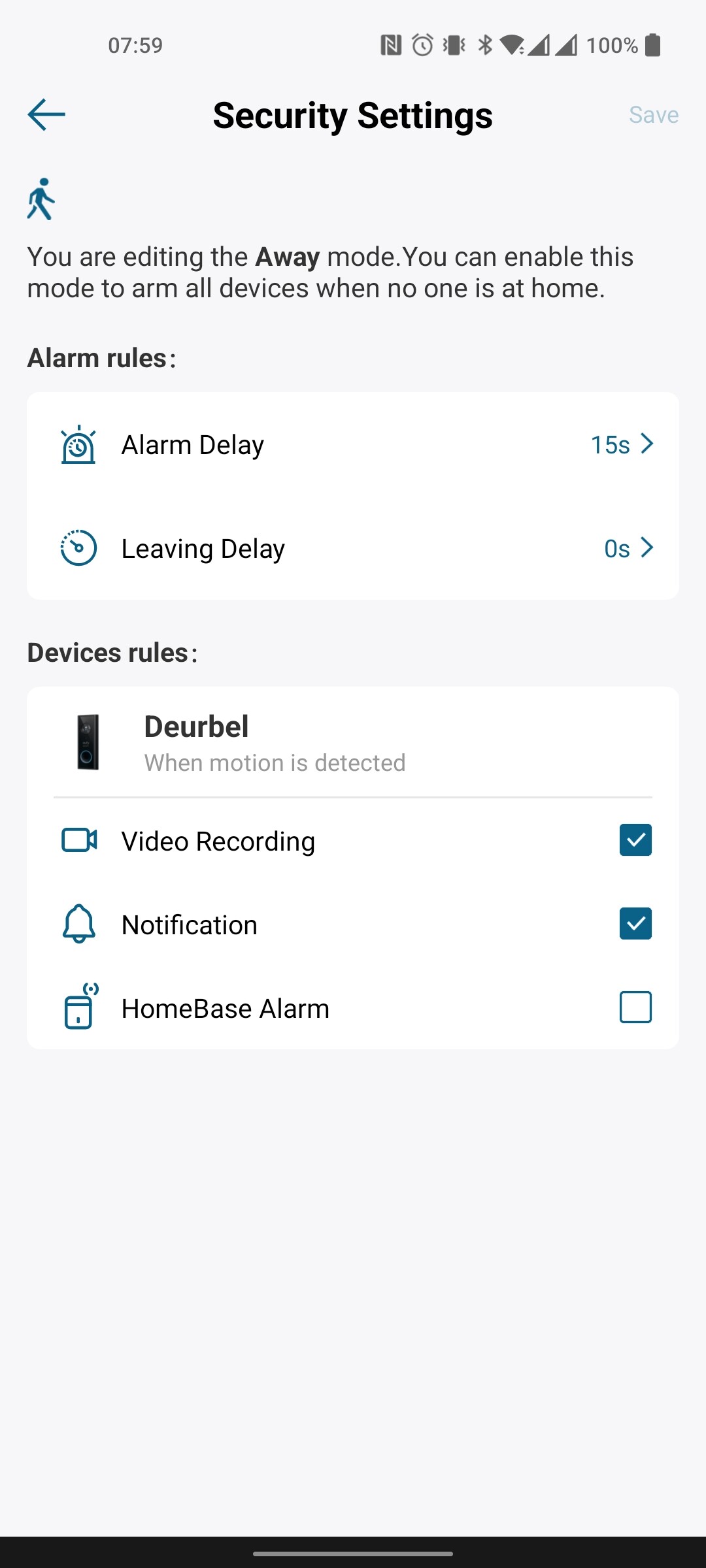

@FranklyEpic you checked these settings? :
Yes, they were all correct

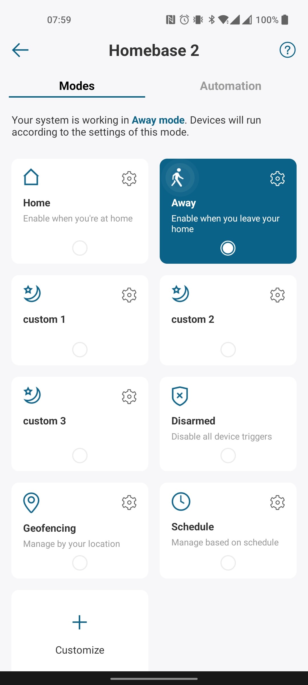

Hi! I did a reset first with no change. I then removed the devices, restarted the app, and re-added them. It timed out but the devices were still added. Both time out when trying to set security mode in Homey, but only one of them did change mode in the iPhone app. But no mode is selected for either of them in Homey after trying to set security mode.

@Ole_Rosset are you trying via a flow or directly on the device.
Both cameras are S40’s right?
Trying directly on the device from Homey interface. Both are S40. Also, in the Homey iPhone app none of the settings are available so I use safari on Mac.
@Ole_Rosset Can you send me a report?
