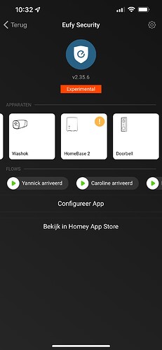

With the security modes I mean this:
So you can edit the modes there and set the settings to your liking and then you can trigger that mode via a Flow

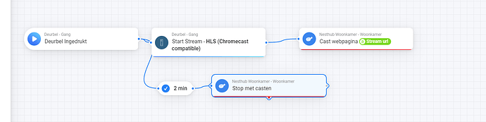

I am trying to cast to the nest hub in my livingroom when someone pushes the eufy but i get network request failed error.
Am i doing something wrong?
Hey @Wesley_Witjes
Thanks!

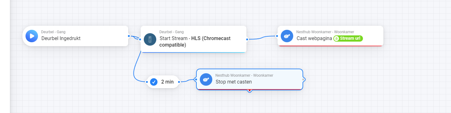

Try to add a delay card. 1s should be enough
edit: did a quick test:
So something like that
FYI: advanced flow inspiration:
