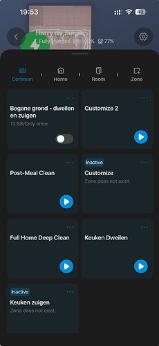

@Jeffrey_Seelen you can create scenes on the eufy clean app
And then trial and error which numbers is for that scene
These scenes
In my case customize 2 is equal to number 7 in homey
There’s no logic in that. :sweat_smile:

Ah, okay. I had already tried to set Scene 1 earlier, expecting it to be number 1 in the Eufy app. But it’s actually random! Thanks, now I should be able to figure it out!
