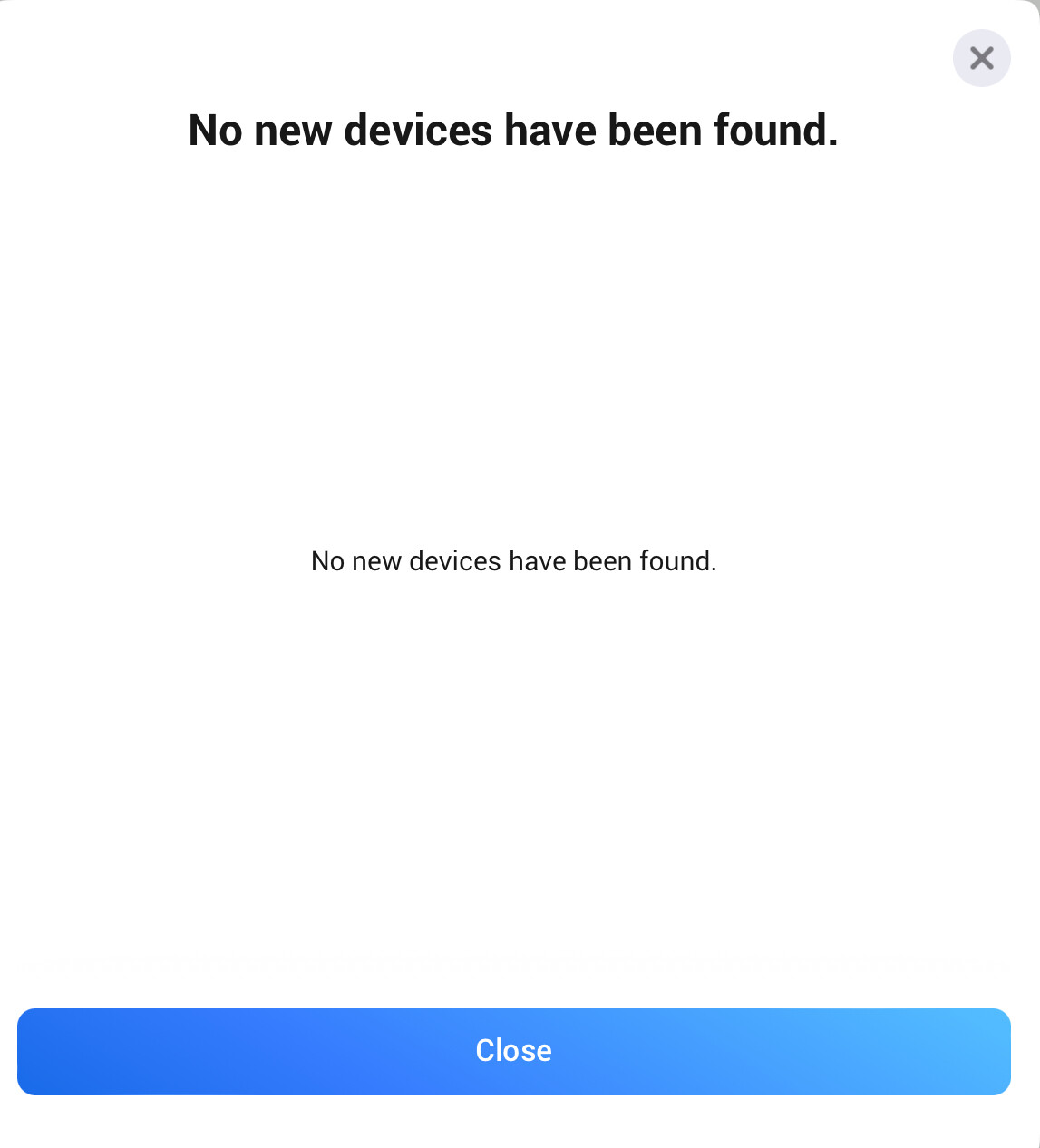

Hi @martijnpoppen ,
My X10 Pro Omni just arrived. The EufyClean app configured, the vacuum works well.
Trying to add to the Homey, but getting this error.
What am I doing wrong?

@HomeyAlliance are you on the test version of the app? → [APP][Pro] Eufy Clean - #546 by martijnpoppen
Thanks, now found it.
