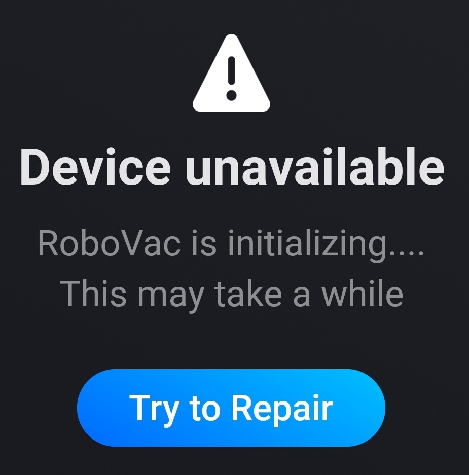

Mine is still not working althought it now allowed me to pull the device into Homey Pro but now the device in Homey Pro and says unavailable.
bce3153f-6fbb-42ee-99a3-1c0642284aa7
@Tom_Tschuor please update to 2.2.7 you’re on a older version
