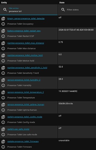

Hello Uğur,
If you’d like to extend the presence sensor entities/capabilities it’ll be very much appreciated.
Here’s the sensor yaml:

and below’s the entities what Home Assistant comes up with
  • the number entities should be added to Homey as slider with these min - max values:
    • max_distance 0 - 6 / 2 digits
    • motion_hold 0 - 200 / 0 digits
    • sensitivity_thold 10 - 100 / 0 digits
binary_sensor.occupancy
button.restart_esp
number.max_distance (m)
number.motion_hold (s)
number.sensitivity_thold (%)
sensor.distance_detection (cm)
sensor.humidity (%)
sensor.illuminance (lux)
sensor.target_moving_distance (cm)
sensor.target_moving_energy (%)
sensor.target_still_distance (cm)
sensor.target_still_energy (%)
sensor.temperature (°C)
sensor.uptime_human (string)
switch.config_mode
switch.safe_mode
switch.show_target_stats

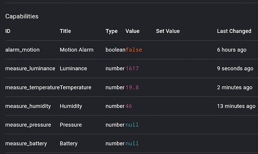

At the moment, this is what works, except for the dim capability
The dim capability errors with
Let me know if you need more info / testing.
Thanks!
Hello, I tried to provide support. I created a test driver for you. Add it with the general Esphome driver. If you report the problematic parts, I will do my best. Have a nice day.
iPhone’umdan gönderildi
Thank you.
This is the result, all currently added capabilities work, except for signal_strength; but that’s because my sensor hasn’t such an entity.

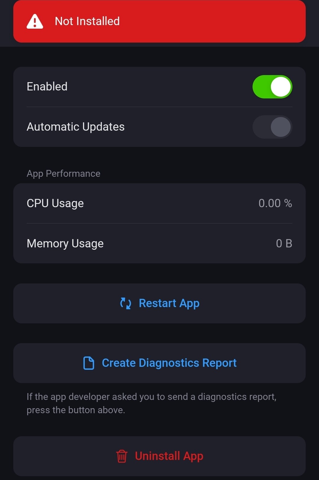

After updating to v1.0.53 I can’t select the app anymore to add new devices.
The app doesn’t seem to start
Diag:
37e900c6-8050-4339-986f-17be12c8ee07
When I press “Restart” it shows:
Yes, I am aware of the issue. Currently, I believe there is a problem with the Homey App Store; it is not downloading the packages correctly.
This phenomenon occurred with an other app as well, it was solved by publishing/uploading the app version again.
Just FYI, the stable version installs without issues.
I’ve sent many new versions so far, but the same problem occurred with all of them. I’ll wait for the system to be fixed. It contains fixes for your presence sensor.
