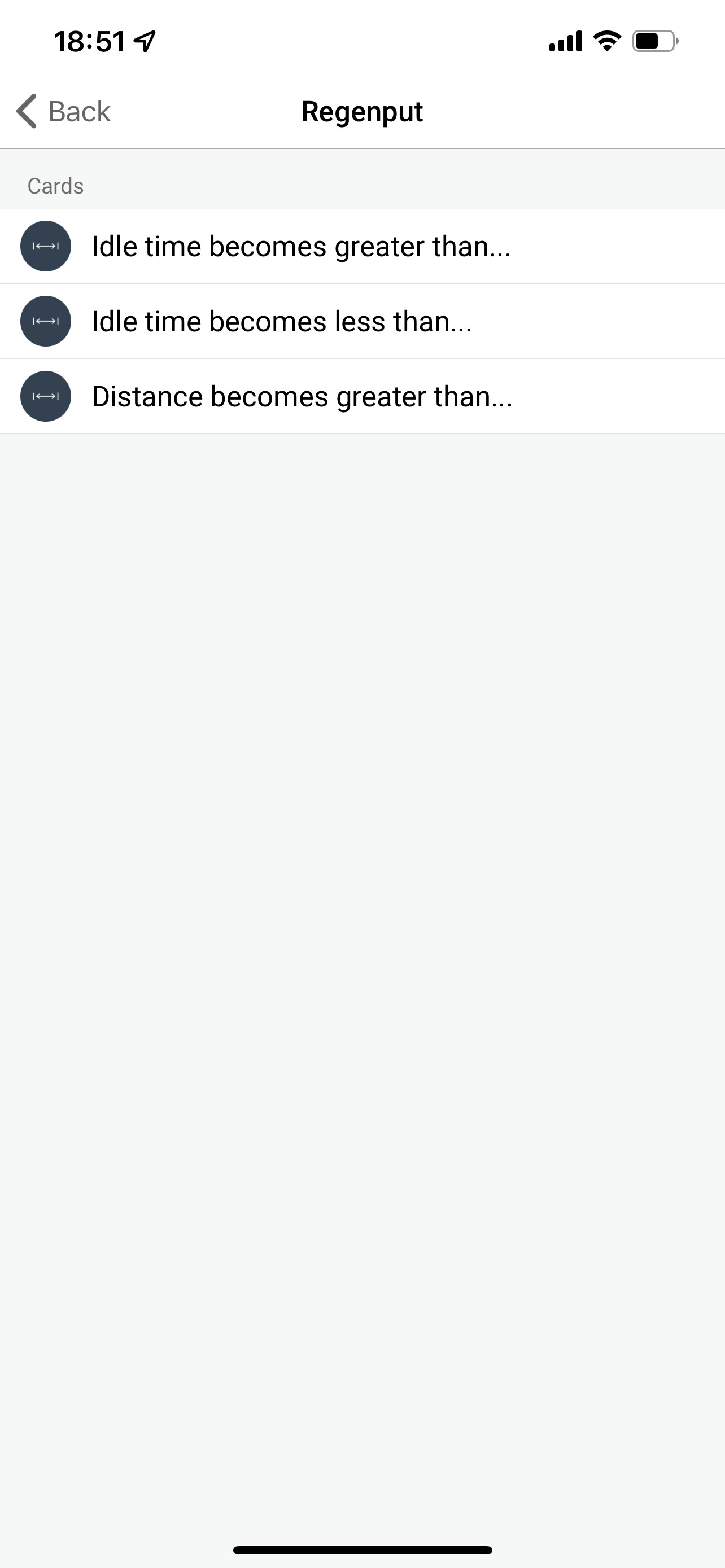

@Joolee is there a specific reason why there only is the option “distance becomes greater than…” ? And not” less then…”? Or invert option? I would like to set a 100% full /50% and “empty” action with this setup. (20cm = 100% / 150cm =50% and 300cm is empty)
A “if distance become…” or “if distance is in between… and ….” Would also be useful
This for my use with “Position - HC-SR04”

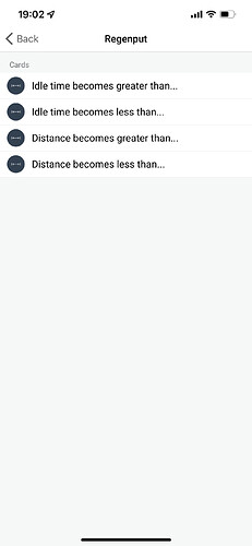

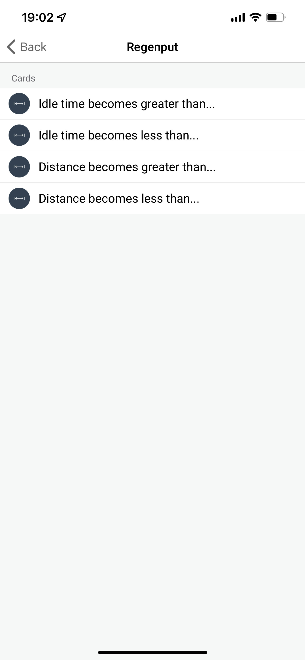

Edit: sooo… less then is here suddenly?
Edit 2: i found that the option less then is not available when you try to make a flow from the tab in the sensor, when i make a new flow from the main i have this option. So maybe a small bug…
