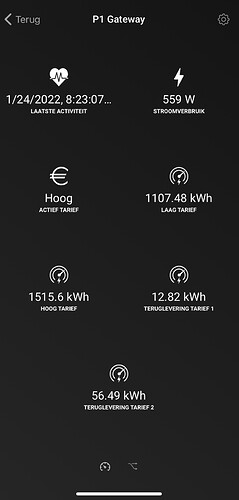

In the marked rule, I see the information of my gas meter correctly. Also the energy rules are classified into groups of three. That should be L1, L2 and L3. Is it possible to show and add these information in the app?
Currently the app shows this:
Diagnostic report: 76a13370-bb1d-4756-bcc0-768ed5c70066
Thanks! I got a lot of information now I can work with. Something is clearly going wrong in the app, I see a lot of entries like this:
