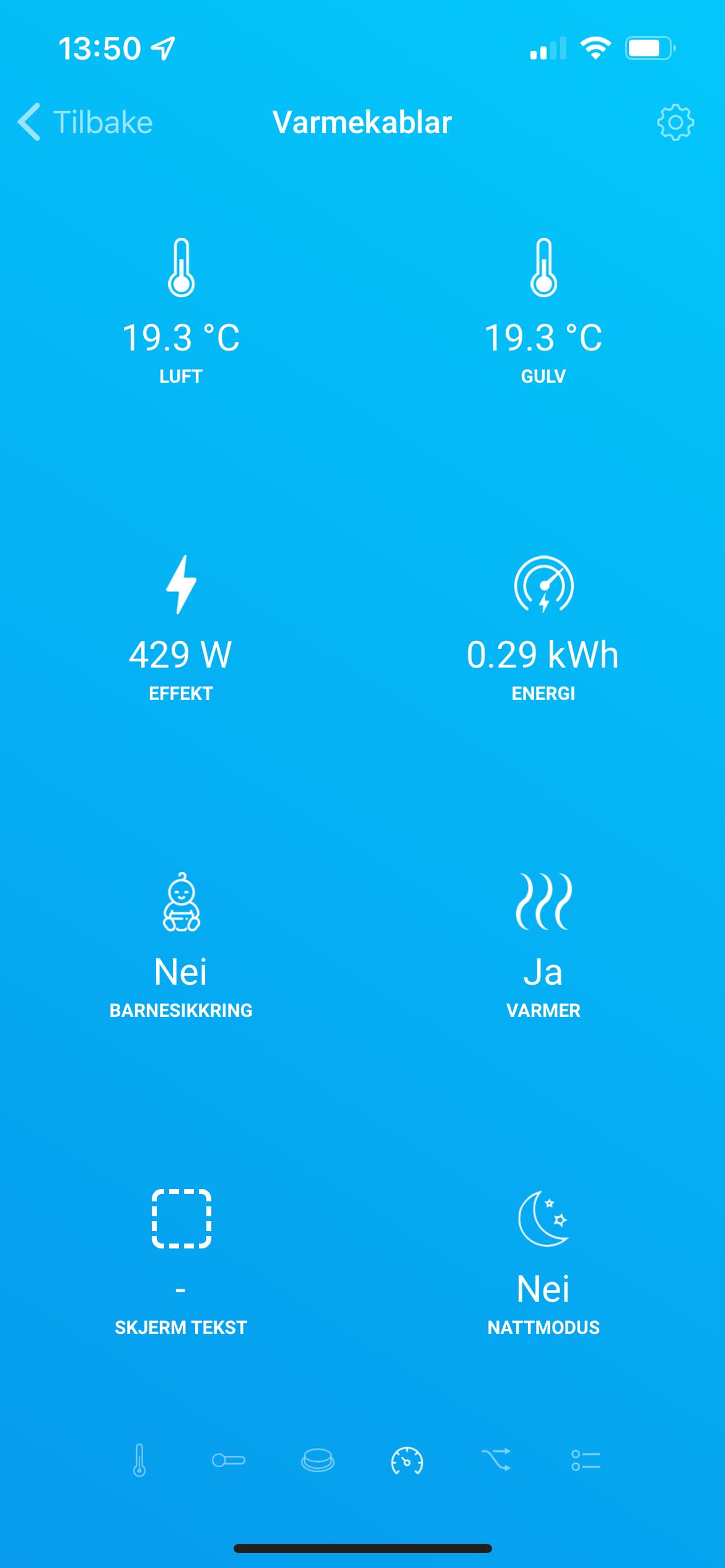

In the app it says “heating” when the thermostat is “off”, bug? See attached photos.
Hi Jonny - In my experience, the heating status isn’t particularly reliable and I often see the same as you - I belive (but don’t know) that this is because this status is not updated as often as the temperature. Same goes for the history tab for the device. Temperature and whether or not it’s heating up or cooling down in the “dial view” seems to be pretty real time though.
Hi!
I have tested now and get Heating: No when I turn off both of my thermostats.
As you probably know Elko has not followed the zigbee standard for this device. And there is many reasons for that. There is many glitches vs zigbee standard that I have tried to patch up. One of them is that there is no way to set up attribute reporting on the relay state (Heating). It will not respond. So I have to pull the value every 60 sec. So there can be up to 60 sec delay
