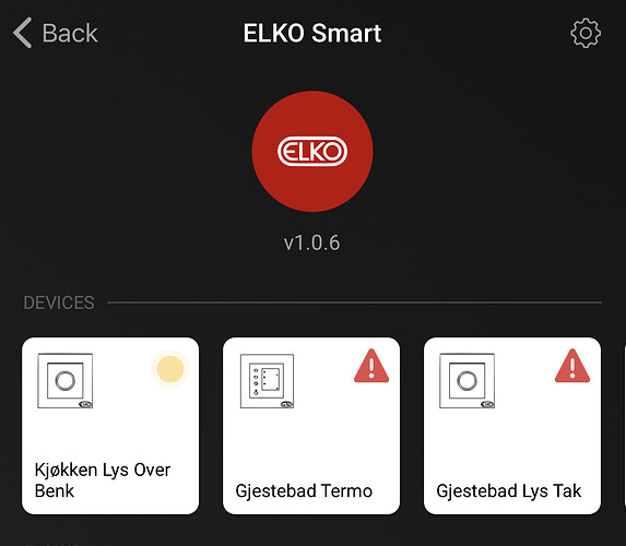

I am struggling quite a bit with my Elko devices. The main concern is that a random number of them are disconnected from the Elko app at any given time. They are still connected to the zigbee mesh, and interviewing them creates a response, but controlling devices using either the Homey app or as part of my flows does not work. Error message in Homey UI is “Device is unavailable” with "Device is unreachable” or “timeout”. It does not appear to be specific devices that are affected, and restarting the Elko-app makes some or all of the devices operate (for a short period) normally again.
Version installed is 1.0.6.
Memory usage is about 16MB right now
I have about 40 dimmers (both pre and post 2019) and thermostats. I have already tried to reset the zigbee mesh, without resolving the problem.
