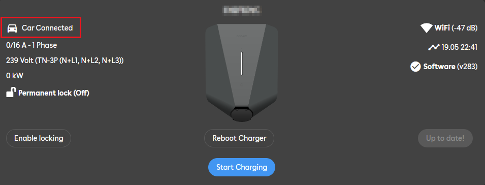

@Richard_B , is it please normal to see status in the Cloud different then I see in the Homey ?
I have eGolf which during connection do some short test and start charging later on as per schedule… unfortunately when checking the Easee Android app, it also shows “Completed” status…
Easee Cloud

Correct, there are differences between the Easee app and easee.cloud on how they display the status.
To make it clear, the Easee APIs return a numeric representation of the status that needs to be mapped to a text status.
When I looked at this initially these were the differences.
//iOS app says 'No car connected', but easee.cloud says 'Standby'
case 1: return 'Standby'; break;
case 2: return 'Paused'; break;
case 3: return 'Charging'; break;
//iOS app says 'Completed', but easee.cloud says 'Car Connected'
case 4: return 'Completed'; break;
case 5: return 'Error'; break;
//iOS app says 'Ready to charge', but easee.cloud says 'Car Connected'
case 6: return 'Car connected'; break;
I feel it is problematic to change status now since many people might use them in their flows. Showing status 4 as Complete makes sense to me if you want to be able to take an action once the charging is completed. Showing Car Connected also here would not make it possible to differ from status 6. I guess this is the reason why I used the app status for this status and not easee.cloud for all of them.
Thank you Richard for details - so is there some way to distinguish between Car connected AND Not charging ? That’s status COMPLETED, right ? I would like to change maximum available charging capacity only when car is connected… regardless of whether charging finished or even didn’t started yet.

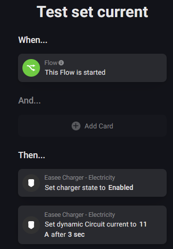

So I connected charger to car, but didn’t start charging - Easee switched to status COMPLETED with Current allocated 16A. I have created test flow to change Dynamic Circuit Current but I see no difference - it’s still set to 16A and there is no entry in “Last API error”. I tried to restart APP and repeat - no difference.
What I can do to investigate it further ?
Diag. ID before app restart : e820633a-fdf5-4f1c-b4e7-781cc5e18ae8
Thanks for the diag report, it actually helped to diagnose the problem. The set dynamic current must have stopped working for all new users at some point in time. I changed the name of the circuit fuse setting, but it continued to work for me since Homey must have kept the old setting behind the scenes even if it didn’t exist any longer.
There is a new test version, v1.2.1. Can you give it a go. The test version is also upgraded to require sdk3/firmware v5 or later.
Seems to be working, I will test it during next days, thank you :wink:

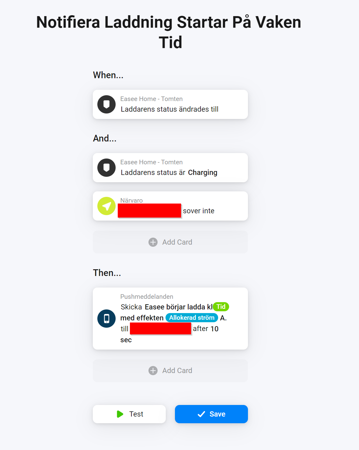

Hi @Richard_B! I might have found an issue, not a huge one but still something I wanted to make you aware of.
I have this flow:
I know @Richard_B speaks swedish natively, sorry to the rest of you. To keep it simple, I want to get a notification if the car begins to charge if I am awake.
The funny thing is, I don’t get a notification when the charger’s status is changed to Charging. I get the notification when the status changes from Charging to Completed. :slight_smile:
Any ideas?

Can’t really explain that behaviour, but I would change the “And…” card to a logic card and use the status passed from the “When…” card.
Something like this
I have set up a test flow using the logic card and will see how it works over a few days.
